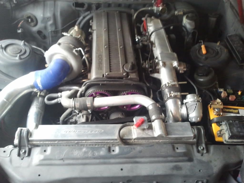

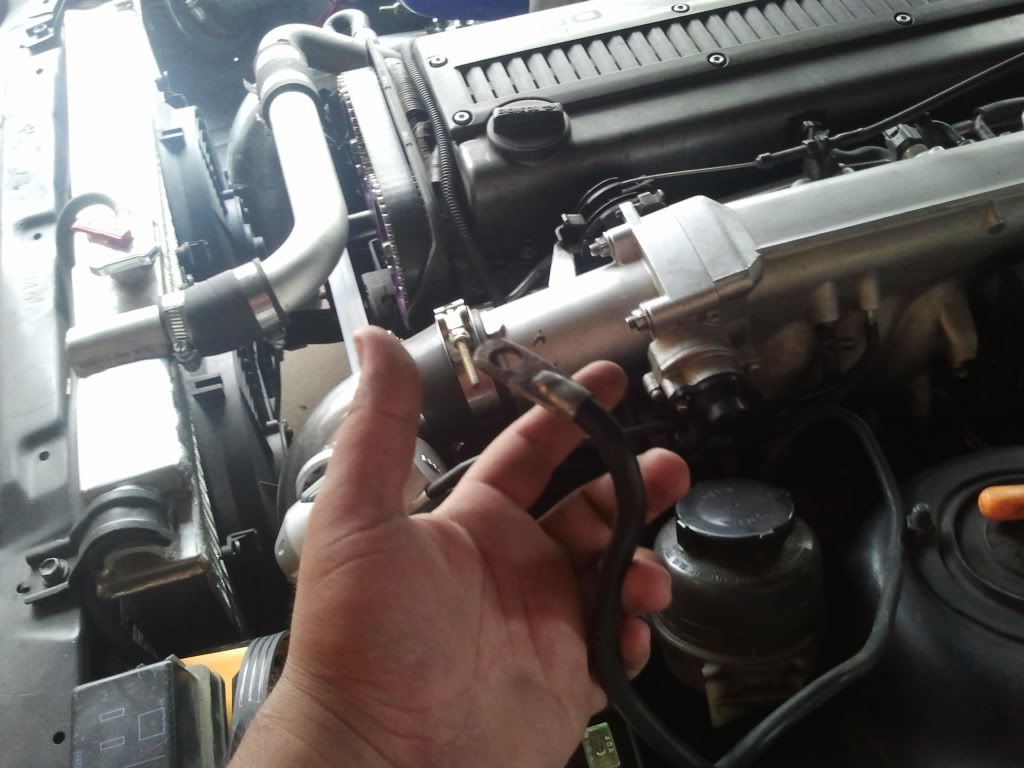

also things i have also done replaced battery terminal, found a thick guaged wire (that is suppose to be grounded to the block but was not) and bolted it to the block, put in a 100 amp fuse and still not charging
here's a quick pic of my current set up.
