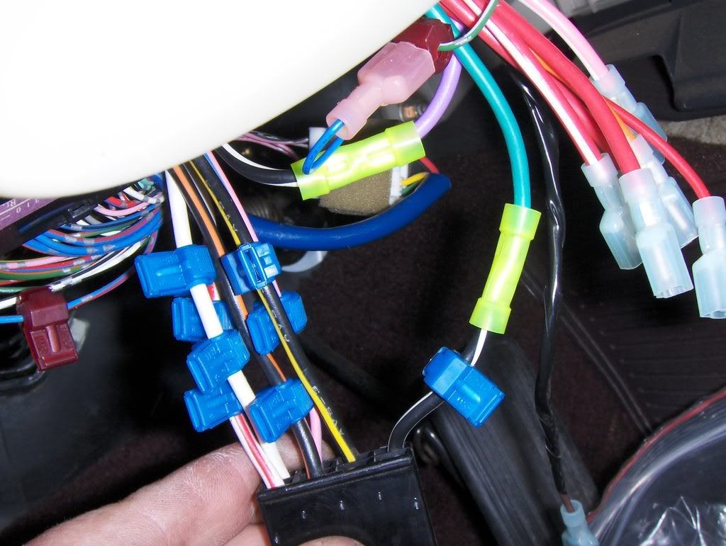

Next lets take a look at the part of the harness that goes down into the kick panel.
This is the very end of the kick panel harness. It has the brake wire, Remotestart control switch and ground eyelet.
Just below the fuse box there is a bolt that can be used as a ground point. Attach the ground eyelet there.
In the pic below you can see the green/white brake wire. t-tap that wire and attach the brown wire labeled brake wire to it.
In this pic you can also make out the yellow/black hood and trunk trigger wire. You will attach the blue wire labeled trunk there.
This pic is of the main portion of the kick panel harness.
This is a pic of the overall kickpanel area.

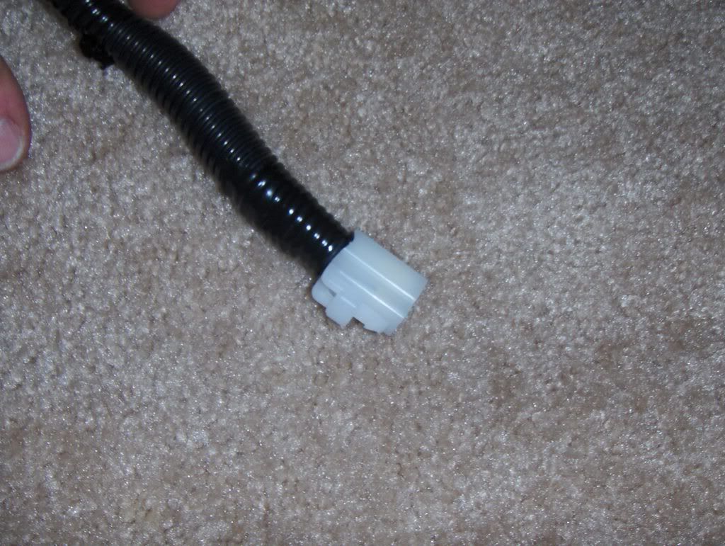

![p549879_1.jpg](https://www.supramania.com/images/pb_archive/p549879_1.jpg)

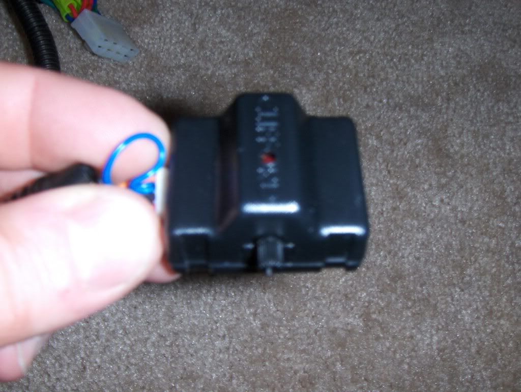

Ok now lets get to work. First lets take a look at what come out of the box you get from me.
![p549879_2.jpg](https://www.supramania.com/images/pb_archive/p549879_2.jpg)
Familiarize yourself with the different components of the kit. Notice the labels on the ends of the wires. these will give you an idea of how these will be laid out in the car. Also take not of the seperate parts like the siren and LED and program switches. Also read through the install manual that come with the unit it is full of info on how to find the circuits in a car and also general info about module location and other concerns.

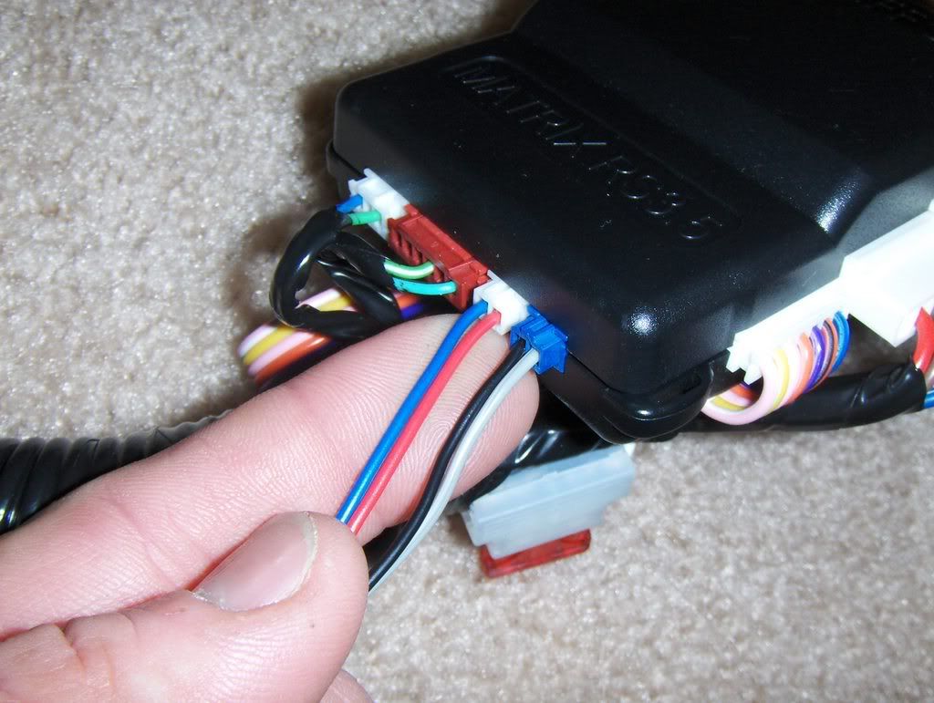

![p549879_3.jpg](https://www.supramania.com/images/pb_archive/p549879_3.jpg)

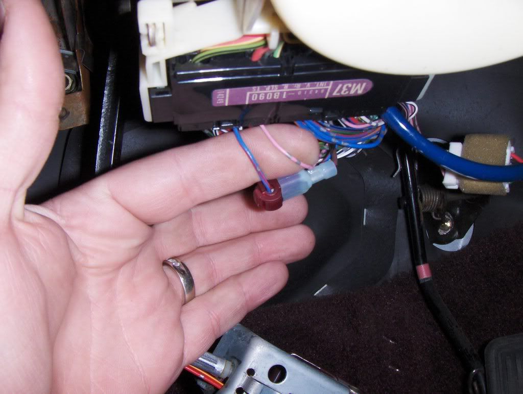

![p549879_4.jpg](https://www.supramania.com/images/pb_archive/p549879_4.jpg)

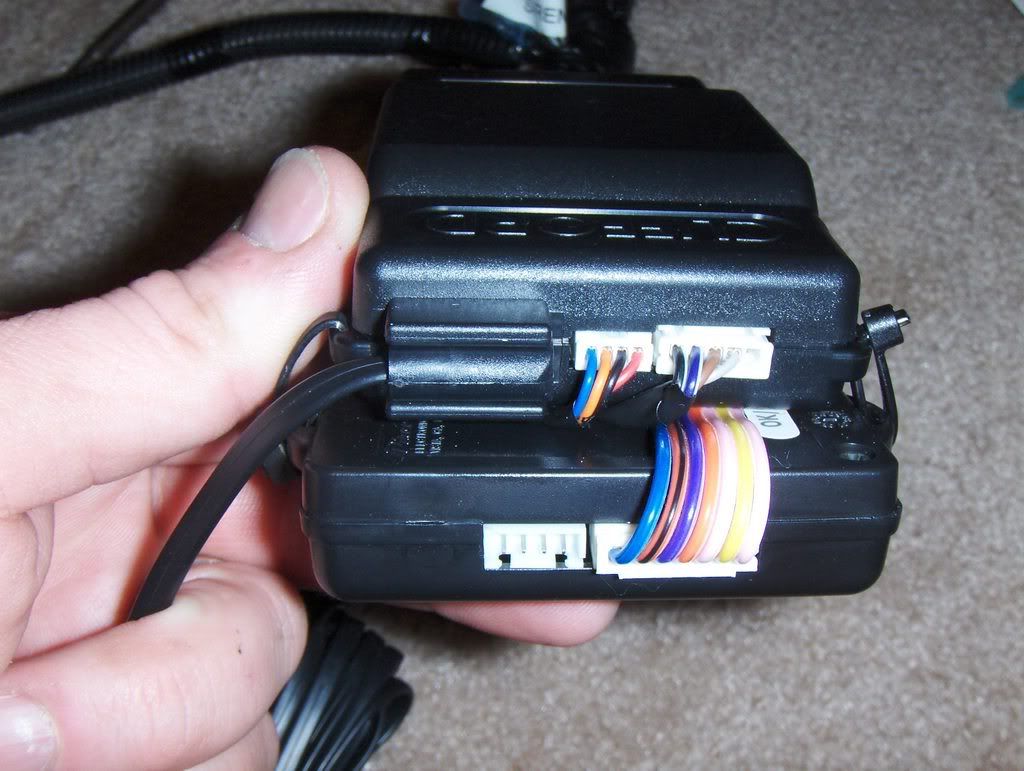

![p549879_5.jpg](https://www.supramania.com/images/pb_archive/p549879_5.jpg)

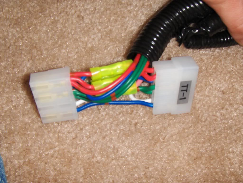

![p549879_6.jpg](https://www.supramania.com/images/pb_archive/p549879_6.jpg)
Notice the two blue plugs at the center of this pic. These are your door harness connectors. We are looking for a total of 5 wires here. Test for the lock and unlock wires using the door trim switch. Test for the Arm and Disarm wires using the key cylinder switch (turning a key in the driver's door key cylinder. The door trigger switch wire is also in the larger of these two connectors. All of these are negative swicthed wires. Meaning when the switch makes contact you will see ground on the apprpriate wire.
