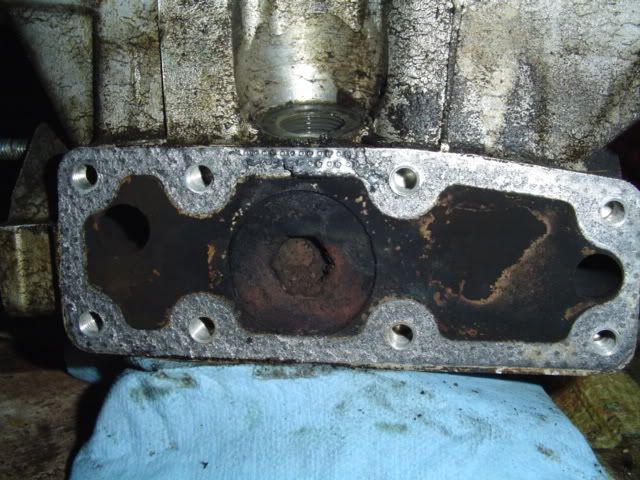

This is a picture of inside your EGR cooler, Toyota felt the need for a plug sealing the coolant from the exhaust gases. Why they did not cast over this, well maybe IJ can tell us that.
If my memory serves me correctly its a 17mm allen head. Not that I took mine out.
And the leak in the front is coming from the thermostat housing or more than likely the water outlet housing where it bolts to the cylinder head, the piece that the thermostat housing bolts to.
And I don't see how anyone could get any substantial amount of torque applied to that one head bolt without a head, so you can pretty much bet it had a BHG before you tore it down, so maybe the EGR cooler theory doesn't apply to you.

Thanks for the replies. The only part of the EGR that seems to be missing is the pipe that goes right from the EGR outlet to the intake manifold... and on the manifold all it has is some homemade block off plate made of nothing more than mild steel... leaving all of my exhaust gases just getting blown onto my intake manifold... its the only part of my manifold thats pure black.

3. EGR Cooler. IMHO, this is grasping at straws, but the EGR cooler does connect to the exhaust and does contact coolant. If the intake manifold is blocked off, then at least you aren't getting coolant into the intake, but this means that the head casting is/may be compromised.

At this point, EGR looks more likely, but in any case, you're looking at major head work. I'd basically scrap that head and look for something to replace it with. Another head is likely to be cheaper than repairing that one.

The big allen head bolts in the top of the head I am not talking about, we all know Toyota had issues with the spark plug gallery, there are 7 plugs in the top of the head, 3 coolant, 4 oil.
It's the big ass one in the picture that has me baffled. Maybe they had to drill the passage to reach the coolant gallery? I don't know, but it's about the worst place to put it.
