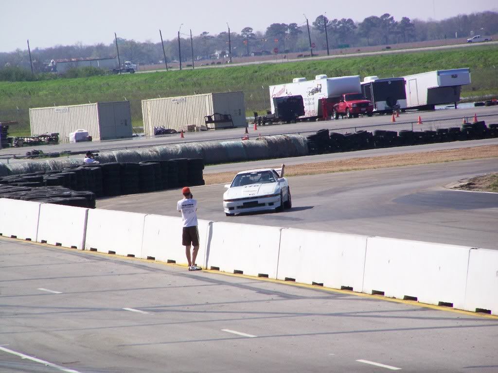

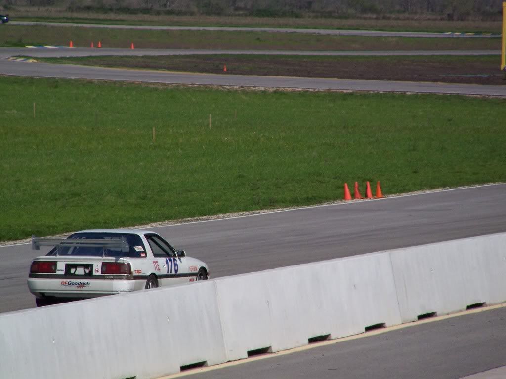

Well, if you strip a MKIII down for racing they tend to be very nose heavy, so just getting a good lip/splitter and getting a wing to get the back to stick usually works. The car in the pics was pretty damn sweet, wish I had more info on it...
5
45
Red one is the S2 car, ebay rips off their images
The white one I took those pics at TX2K7, outside of that dunno enough about the car...
