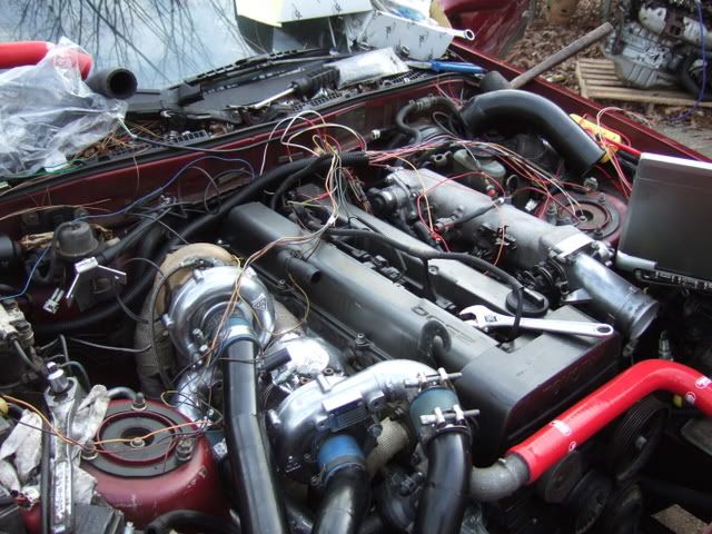

Work in progress. Almost done!
This is why plug n play harnesses rock, because a job with MoTec as a wiring tech is NOT in my future... But it will look good when finished.

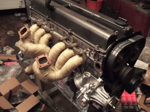

Jeff, those pipes look pretty dang good wrapped like that. Maybe I should do mine since my oil lines and drain lines run in between the runners. What do you think?

The manifold and turbo housings were already thermal coated with gold, the header wrap will help keep temps down, and I plan to run the same over both turbos, both individual downpipes (open downpipes) are wrapped also. Even the return lines have heat wrap. The feed lines I kept naked.
I like the idea behind keeping heat where it belongs.
