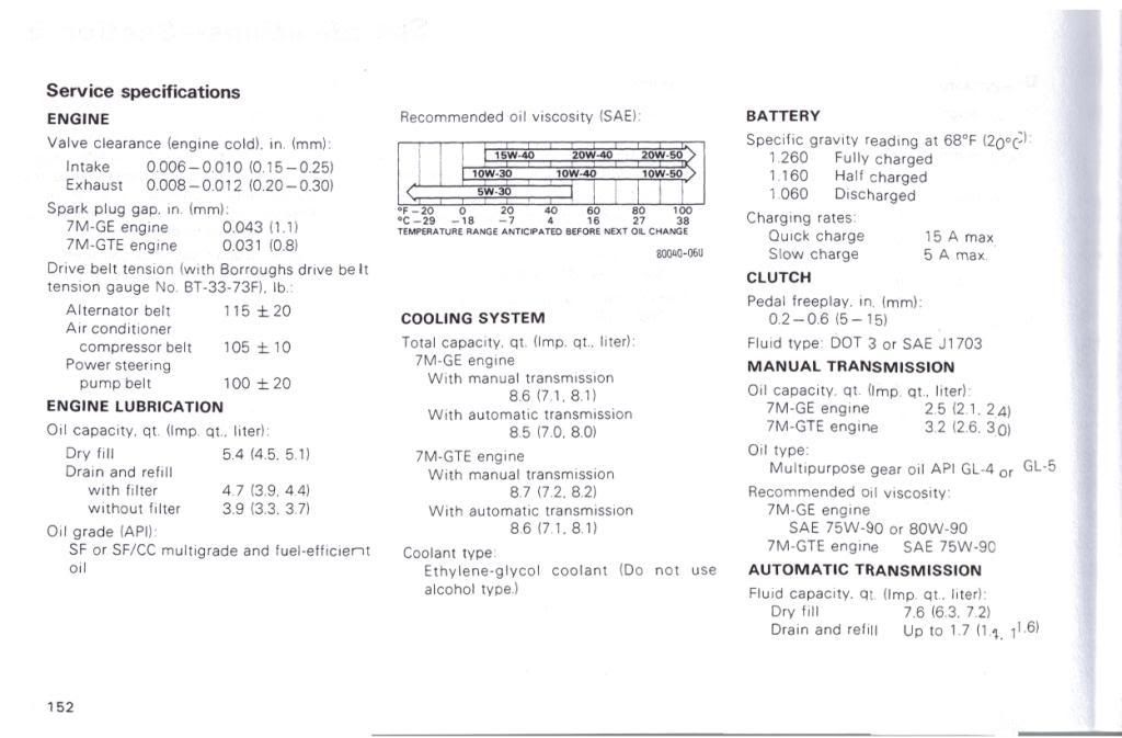

i'm with mtt on the oil being ass thick, i'd like to see where it says about putting 20w50 in the engine and 5.5 quarts because everywhere i look i read 4.7 w/ filter and 10w30 for normal weather, and 10w40 for hot temps.
does it change in certain states?
btw what type of filter are you using MTT.
i ride w/ 5q's of 10w40 mobil 1.
I just wanna know where all this information is coming from.

Here is a page out of my users manual. It's an 1987, and it was originally purchased in California. It show 20W-50 suitable for 80F+ weather.

Just run 15w40. The clearances in the bearings were made for it. Running synthetic 10W40 might be a little too thin. Synthetic oils hold up against heat breakdown better than regular crude oils, but 15W40 is as low as I would go in a 7M or or 1J/2J engine family. I run 15W40 in my Supra (GTE) and My Cressida (GE) engines. The bearing tolerances in these engines don't call for your typical 10W30 and 5W30 oils. They do need higher viscosity numbers when compared to most other engines.

weird,,, mines 92 manual its even printed then and on that oil viscosity im missing the top arrow, huh wonder what they were doing?

At the risk of appearing ignorant, that chart always confused me a bit.
Does it mean that 10W-30 is good for use under conditons between 0-100 or so?
15W-40 is good for 10-100 ect..
I am running 10W-30 Mobile 1 right now.
The car will never be driven with temps. under 20 and it very rarely gets over 100 here.
Sounds like 15W-40 might be the way to go. I do plan on staying with Mobile 1 however.

I may be wrong as well but I take it to mean that 10w-30 is good for 0°F+ However you should pick the one located in your temperature range so that you receive the best possible protection.
