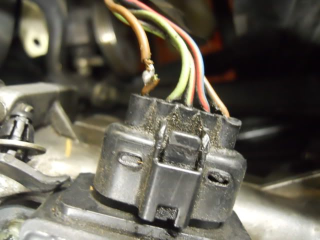

Also found this wack ass splice... if you would even call it that.

Put your finger on your IACV, then have somone turn the ignition on, do not start the car, you should feel the IACV move. If it does not, it might be stuck/need cleaning. Try that and report back. Next if that checks out, you had codes relating to the AFM. You can try fixing that pigtail, depin and using new wires, or geting an oil one and splicing it in.
If after doing those things, you will need to replace the AFM with a known working one since those are all AFM codes. I am just letting you know what it could be, try the IACV first, if you feel a click, go onto the AFM pigtail, then replace the AFM if all else fails. I know how it can be with those electronics, I hate them. You will not have any codes are clearing them since you have no driven the car. The only code that is a real time code, will appear when something is wrong and go away right when it is fixed, is code 51.

Might have sucked water up through the intake which would be why you got the afm codes and it wouldnt rev. Clean it all out and make sure the wiring to the afm is good.
