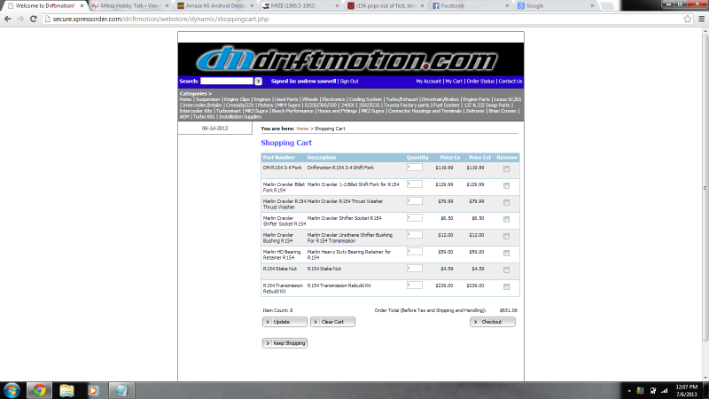

ok guys, heres my list from driftmotion
can anyone tell me if theres something im missing here, or from another site before i check out please?
also, if theres something on the list thats cheaper from another site please share.

i decided im going to go to marlin direct, the only reason being is the rebuilt kit. the kit that driftmotion sells is factory toyota where marlin sells the heavy duty stuff in their kit. the only part ill actually need from dm is their 3-4 shift fork. hell, marlin even sells the snap ring pliers i was going to need. one stop shop.

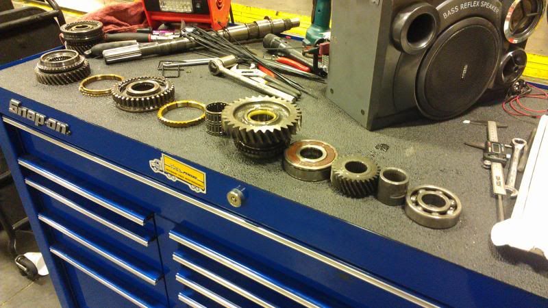

this is how its coming
everything went great on the input and counter shafts. after i got the bearing off of first i found 5 pieces of thrust washer (thanks for the help there guys). if you look close at the 1st gear clutch hub you can see a taper on it, it and the front of first gear got into it with eachother and gawled up both horribly, bad enough to melt the first gear bearing spacer (plastic/nylon ring) to the point it turned black in a couple spots (ring is installed on back of gear just for the pic, im not installing it this way)
for now i stopped and zip tied all the gears together in order until i can track down the 2 extra parts.

A better picture would be nice. The clutching teeth all look rounded. Their job is to hold the gear in place. When rounded, it pops out of gear.

teeth are fine, sorry no closeups were taken.
everything but the front of first gear and the back of #1clutch hub (where these two parts make contact is gawled and ill have to buy both parts and a bearing spacer because of it) all other parts spec out great.

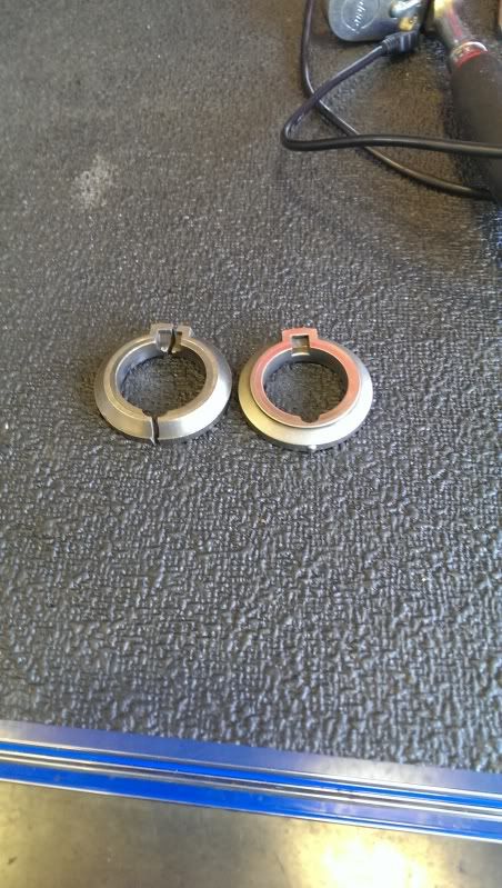

i had a complication when installing 5th gear thrust washer. it fell off its key way while i was tapping it all back together and i locked it into the wrong key way on the washer. when i torqued the stake nut on the end of 5th gear it cracked the thrust washer in half.
i wasnt having any luck getting a new thrust washer from any toyota so i googled it. thats whan i noticed a bunch of jeep parts pop up and thats when i remembered watching the ax-15 trans rebuild on youtube because of how nearly identical it is to our trans. the washer from the ax15 looked identical to the r154 so i went to a junkyard and found a 5spd cherokee and got the washer mic'ed out...both spec out identical. 2 subtle differences but only in shape of the taper and a little nub sticks out on the ax15.
