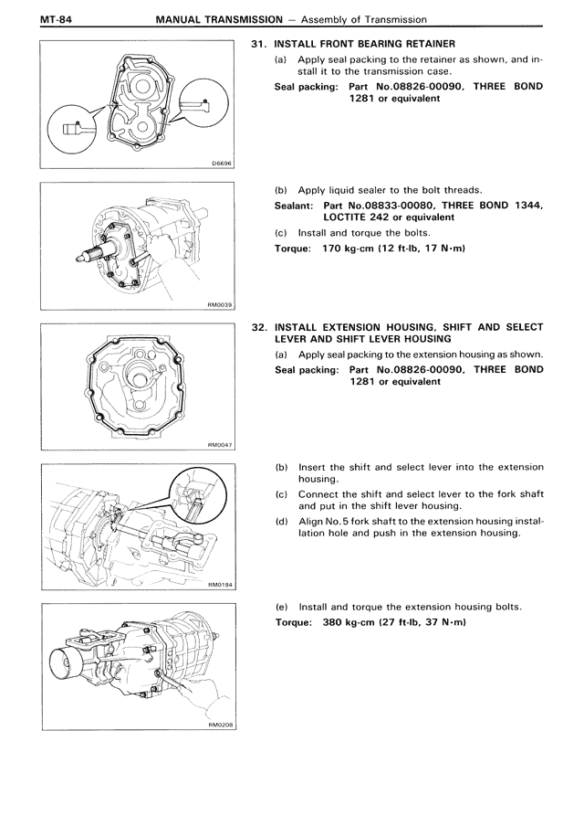

In this photo you can see it in the very last picture
