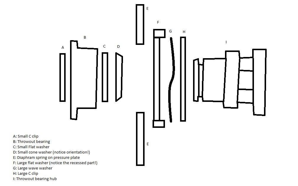

The clutch is a used one, a clutchmaster six puck with a pressure plate that says Toyota on it, so I am guessing it was modified? I did not change the throw out bearing or washers. It did seem fine. It is the one that I bought the car with.
