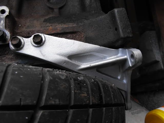

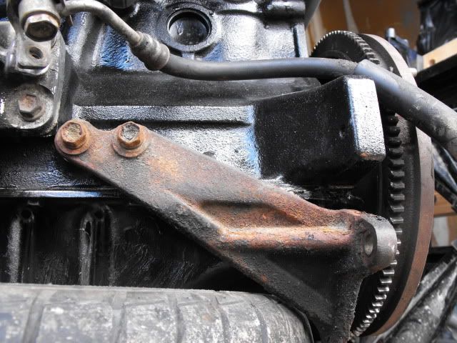

Anyhow, here are some pics of what appear to be the differences:
Right side, the 89+ is definitely thicker where the bolt closest to the back of the engine goes:
And here is the difference between the pre-89 and 89+ for the left side.
pre-89:
89+:
You can see the rib is a little thicker for the 89+.
