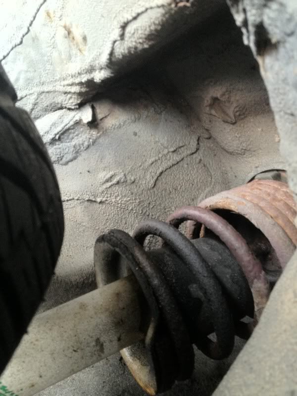

I have TEMS and I do realize the springs are a separate deal from the shock but my current springs are looking pretty old.
I think I will just stick to getting new Illumina struts and some springs over getting coil overs.
