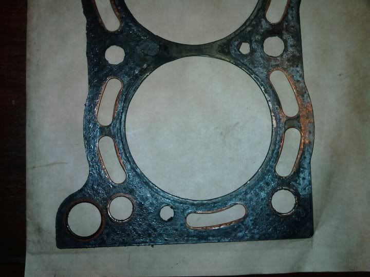

So i blew a head gasket about 3weeks ago parked the car as soon as it showed any type of signs.
Took the car to get checked at a shop they confirmed it was the head gasket.

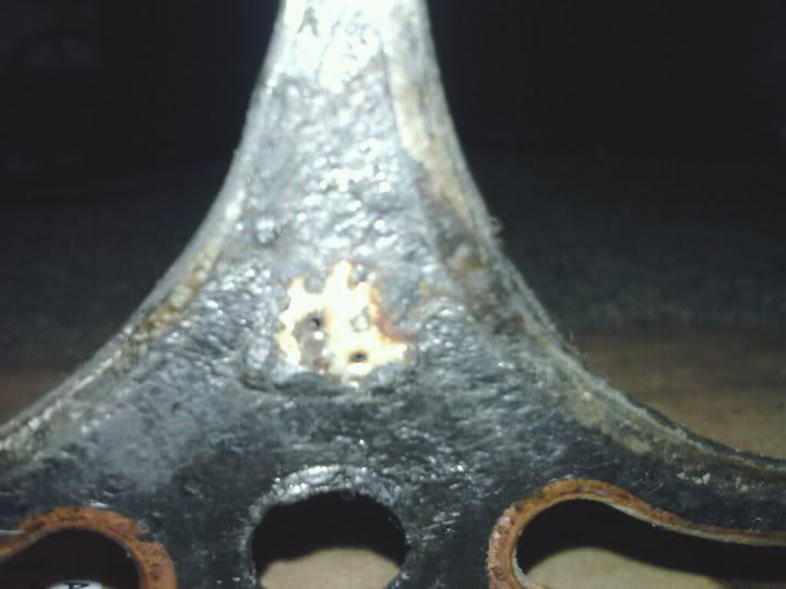

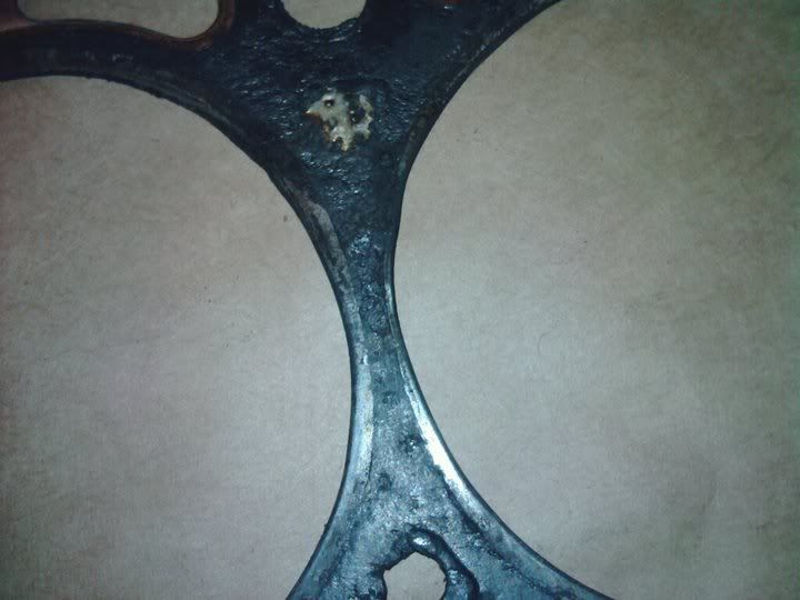

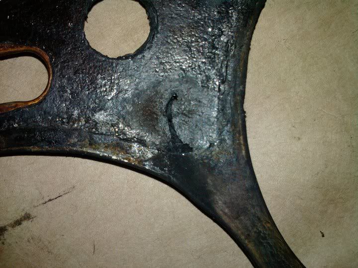

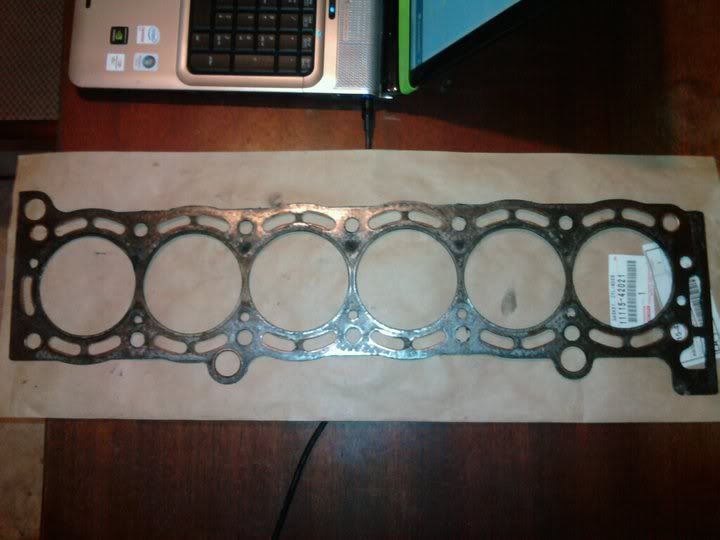

Well i took off the head today to find this.

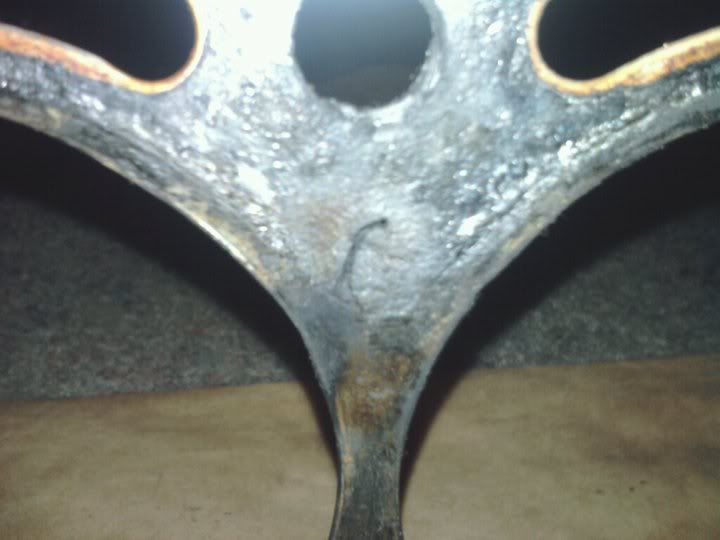

The Gasket wasn't torn at all but by the number 6 cylinder it has a slit that you can see right threw.
my question because im not to well educated on head gaskets is that enough to be considered a blown head gasket or do i have a different problem.
Bottom of slit in gasket
Top of gasket

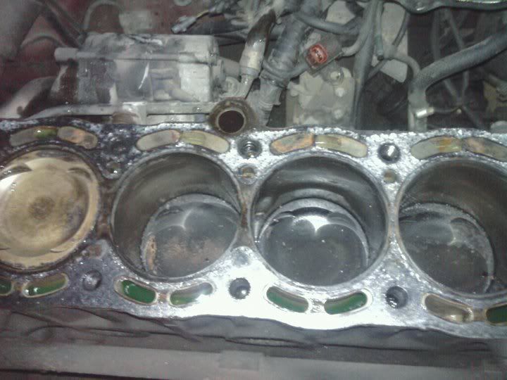

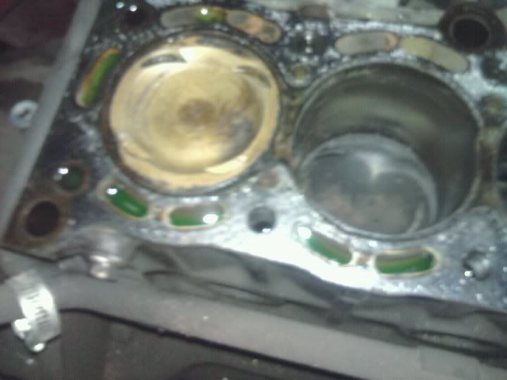

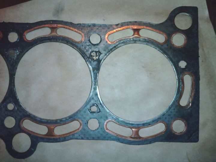

pics of the number 6 cylinder

Post pics of hg cause in that one pic to me it looks like both sides of the coolant jackets are blown. Any deformation means its blown.

It looks slightly blown on the combustion rings.

yA no6 was def blown.
Also you should always drain all the coolant so you dont mix more than you have to in the oil.

Between number 5-6
5 and 6
number 6

There is deformation on the rear of the gasket. Check for cracks on the block and head and bare min pressure check and machine head.

I think it goes without saying that you should get that oil out of there yesterday. Never a bad idea to inspect the bottom end and make sure your bearings are in good shape still too. Also be a good time to replace the oil pump if that's original too...

#6 was definately out of round and was pushed into the coolant passage. That's definately not the original gasket either, as it came off in one piece.
