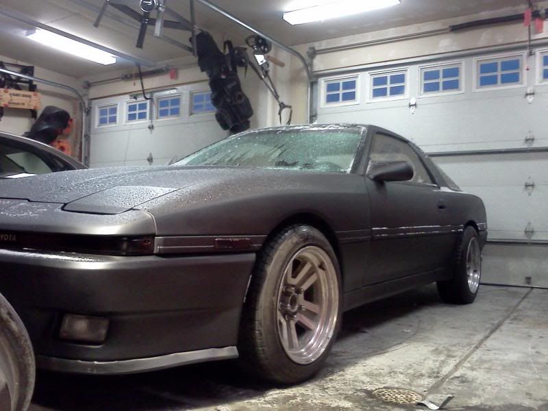

the fronts will be 16x7 +16 with some 225 tires on them, rears are 16x8 -12 also with 225's on them, but will be upgrading to 245's at least soon. pic shows the 16x8 on the front of the car. the 16x7's sit pretty flush on it, poking out just a little bit.

Uhh... have you test fit those yet? Just some rough calculations, those wheels in the rear are probably going to be a good bit outside the wheel well. If you don't like super stiff suspension, you're be chewing up tires pretty regularly.

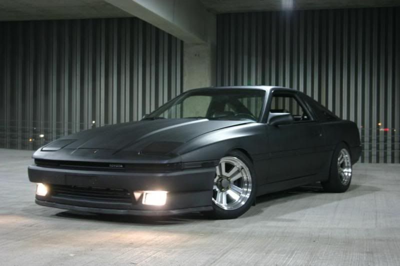

I did not like it one bit...so I bought a set of Megan Track coilys. The stance speaks for itself. With 205 50 16 all four.

nice man i do really like that stance you have! ill be looking into getting some of those when my current setup wears out

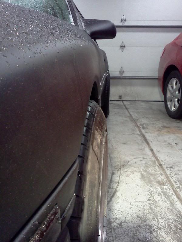

so i have H&R's all around with Tokico Illumina II's now and its pretty low. i have about a finger of wheel gap in the back, and that's with my tools and 2 subs back there. and yes, i do have some rubbing going on with the rear drivers side tire, so im looking to flare my fenders out a little bit to compensate. but man i'm just so in love with the look of those starion wheels :love:

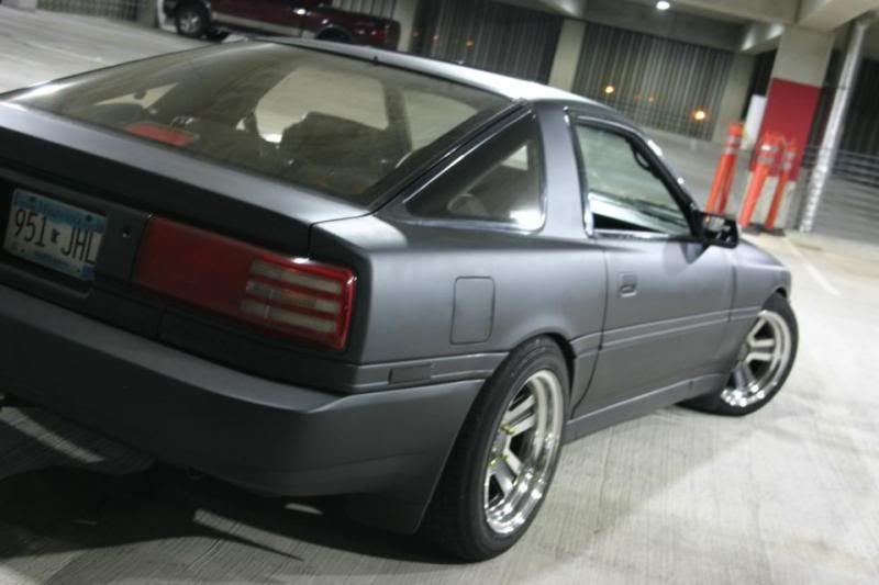

I like the way your tires look with the 205s... only problem is you only have 205mm of tire on the road... I would almost suggest looking into getting the wheels machined so they sit in more and you can get a wider tire on there... Just my preference though... Not trying to impose on your look. Coilovers would be your best bet so that you can fully adjust your look and custom tailor your fitment. I was going to suggest H&Rs, but it appears you have already resolved this issue. I have a friend with the Lincoln mesh 16s on 2255016 tires and it sits awesome. He had a little rubbing in the rear, we rolled his quarter panels and no more rubbing. I'm not sure on the offset of the wheels but it is pretty aggressive for a stock wheel. Good luck on your set up and look forward to seeing some pictures.

^^ To go further into the guy above, that is banking on the fact he has his rear balanced, some people now that are into stance use some pretty decent amounts of negative camber, (can't see the pics on my phone too well) so that 205mm could even be reduced.
