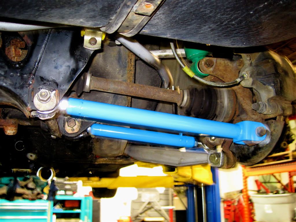

Now I'm kind of confused. I had a new set of OEM control arms installed with the ES bushings, the arms are now in a box on the shelf. I took those off and put on the Beech arms:
The bushing goes in the hub and the U shaped end goes around-over it and bolts up.

[/COLOR]Do you have a picture of the bushings installed. A shot directly under them.
Do you your arms have heim joints on them like this
[/URL] Uploaded with ImageShack.us[/IMG]
Does it look like this?
SWD Fredester 3
Apr 25, 2008
674
baltimore maryland
Same helm joint at the sub frame, ES bushing at the hub.
I think Wes was trying to source a different poly bushing to replace the helm joints but couldn't find any that would work with the arms.
So are you saying that you do not have any movement to the arm. Do you still have the same oem knuckle bushing?
