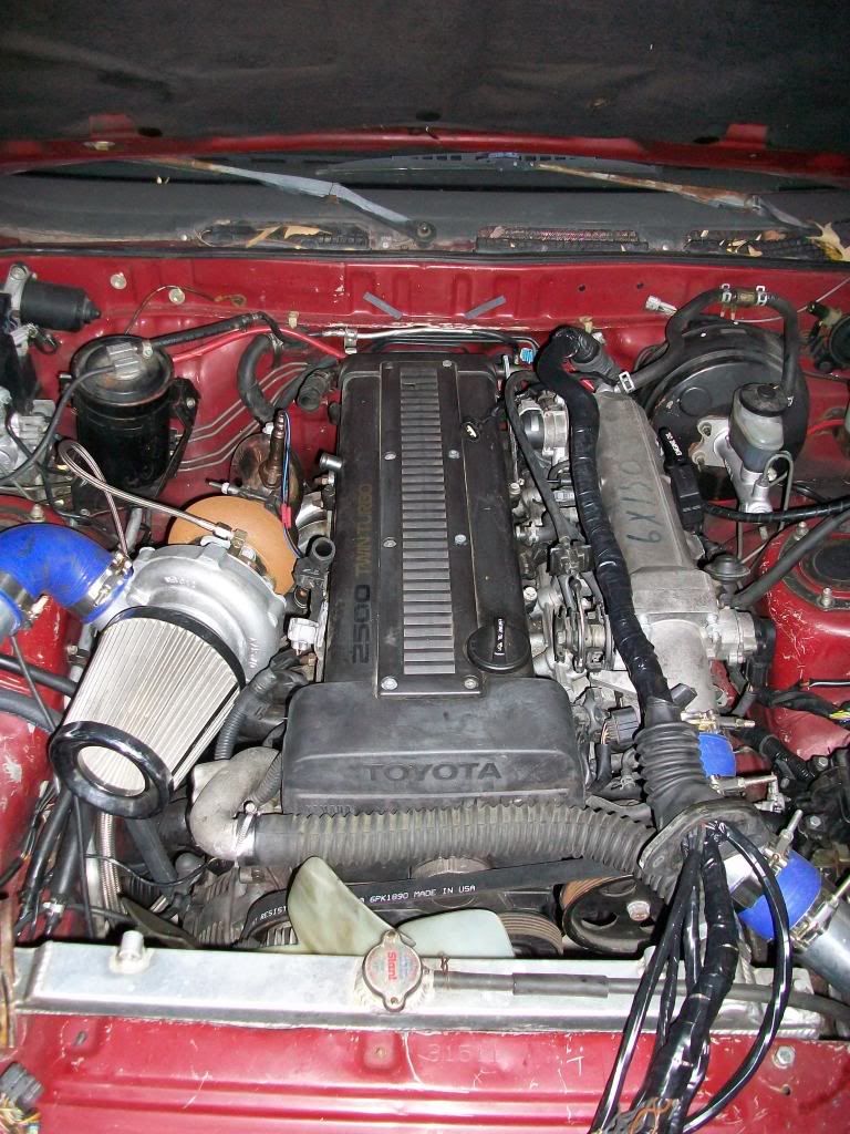

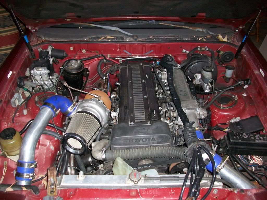

UPDATES, UPDATES! SHE RUNS!!
I got her running about a week ago. But the idle seems high, i thinking either because its cold or the ISCV is gone. Im going to take it around the block when I get my wastgate done to see if it just needs to be warmed up. I really can't let it idle too much because of the sheer volume of the motor w/ just a 3" DP.
