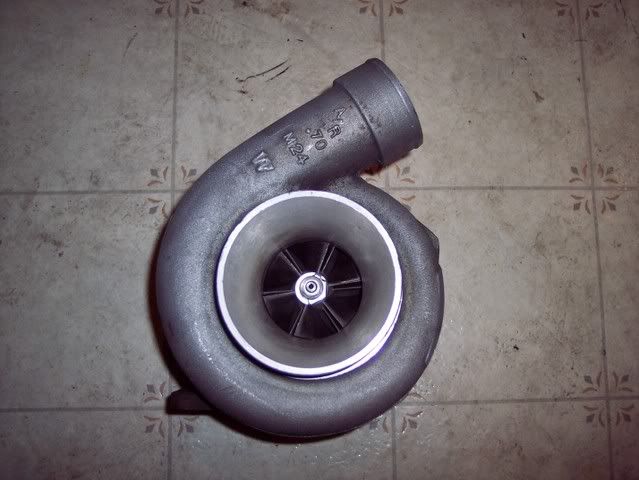

Because you aren't driving a DSM. For the extra ~$100 at most you'll have a much better looking compressor housing and wont have to mess around with a 2.5" -> 2.0" coupler (assuming you have 2.5" piping)
Its this:
Or, this:
Supra_Villan
needs his car done
Nov 10, 2007
662
Wellsville MO
Or even a non-ported s-cover will do just fine
Your throttle body is 2.5 inches roughly, you don't want the turbo outlet to be a restriction.
