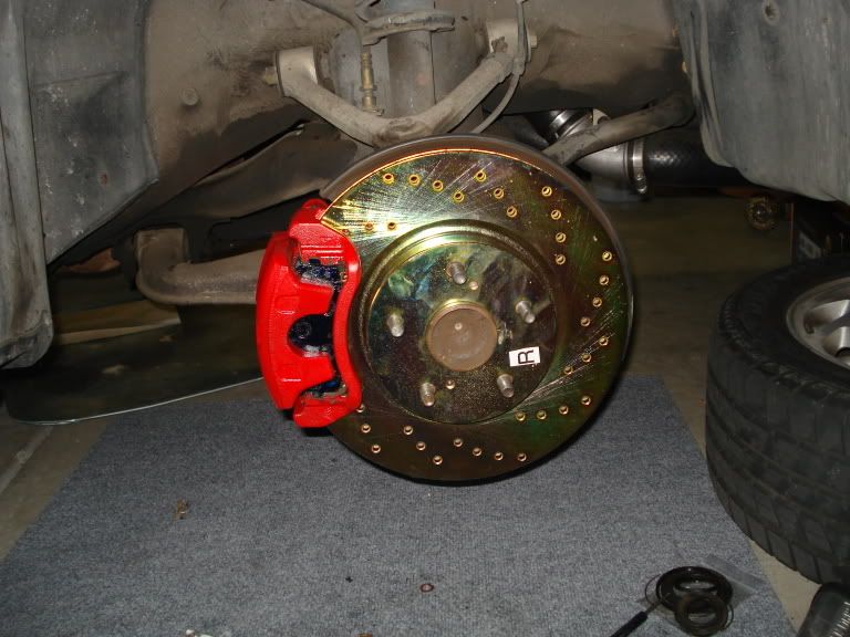

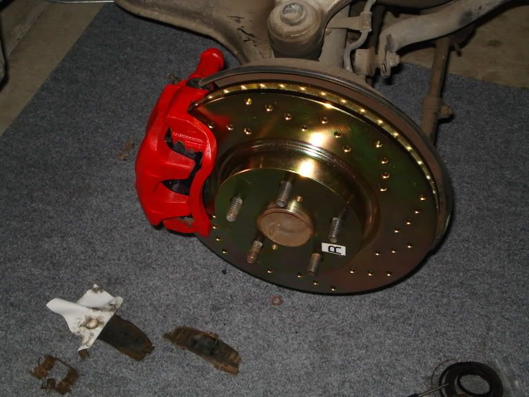

and a nice little tip for ya, wire wheel off the hubs where the rotor sits, because if you clean that rust off, the rotor goes on a lot smoother and your not fighting it.
heres my brake job i did.
