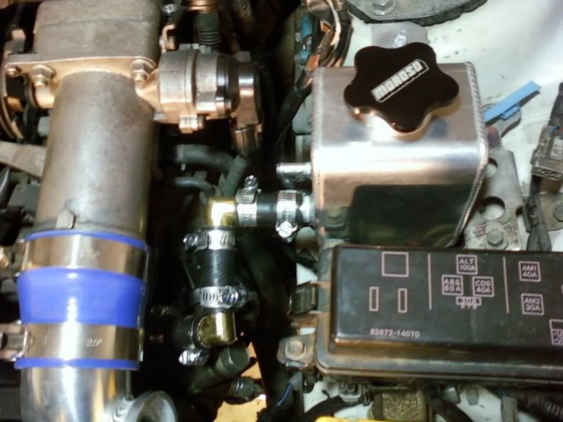

I went with a Moroso aluminum tank meant for a mustang. hahaha you guys are gonna get a kick out of the pic once I get it posted, either that or flame me!! hah!

Finally getting to the point where I need to tackle this. I'm mounting my PS res by the fusebox. I have it temporarily mocked up using the old 7m coil bracket with a piece of aluminum to secure it (pics to come). I'll have someone locally fab me up a legit bracket soon.
So, my problem is the bottom of the Beech Performance tank is a -8, which then has to go to the nipple on the PS pump, which I believe to be 5/8" (correct me if I'm wrong there). No -8 line will fit that without using some sort of adapter. Someone mentioned a -AN to barb adapter. I guess I'm going to need a 90 degree -8 an to a 5/8" barb adapter. Haven't started looking yet, but I'm guessing I won't find something like that.
I'm still new to this -AN and misc fitting, so if anyone knows how I can get around this, please post of suggestions!
BTW - The new Beech Performance tank features a -10 on the bottom to go to the pump, so that makes things a bit better. I really don't want to have to order another $78 PS res, though :icon_mad:

fstlane88;1744878 said:
If you have room, the easiest way would be a -8 an female to -10 an male adapter fitting on the bottom of the reservoir and then a -10 90* push lock fitting.
That type fitting will allow you to use virtually any rubber type hose from the bottom of the reservoir to the pump.
Links,
Adapter
http://www.racepartssolutions.com/proddetail.asp?prod=FRA4973
90* fitting
http://www.racepartssolutions.com/proddetail.asp?prod=FRA2090
HTH
Thanks for all of the info! This will def help me out a lot!
