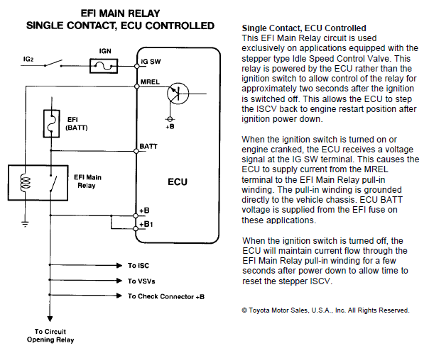

So I found a diagram from Toyota that shows how the M-rel circuit is supposed to work.
The part that confuses me is when I metered out the M-Rel pin with it not wired to anything at all its output mirrored 12v switched ignition. As in key off no power, key on full switched power. When the key was turned off, voltage dropped to zero immediately with no 1 second delay?
Is the absence of voltage at the M-Rel pin meant to trigger the the relay??
