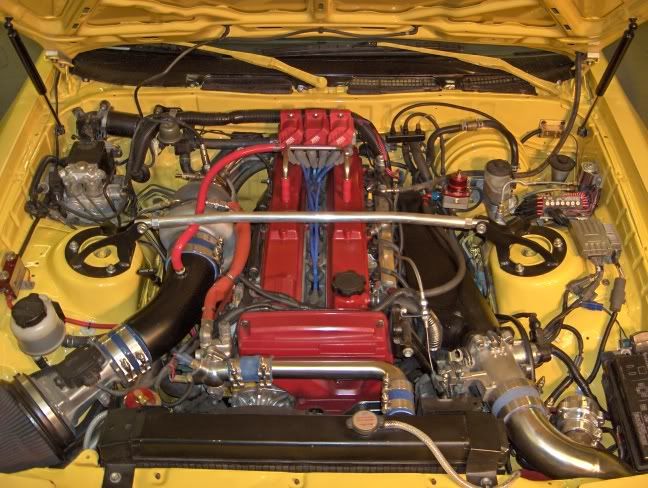

That's not the big problem actually (though it's not a great idea)...the only vac source is the intake....not very effective. The best would be a source right behind the TB w/ a check valve to prevent back flow under boost.

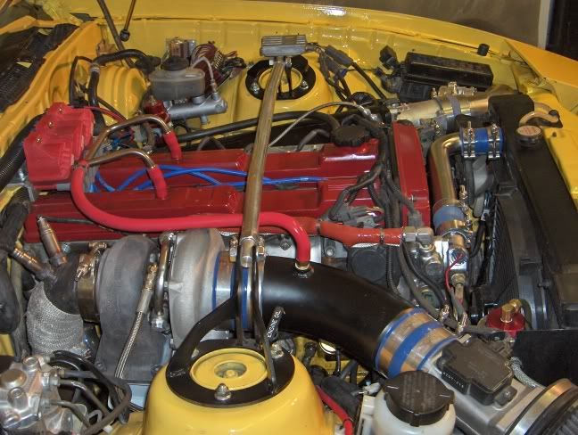

starscream5000 said:
About the picture in post #34... What was that person thinking when He put the oil catch can on the valve covers?? :aigo:
What is the problem with that?
(I'm sorry if it's a stupid question but I'm sure it's not searchable and I would like to know)
starscream5000
Senior VIP Member
Aug 23, 2006
6,359
Hot and Humid, KY
That catch can is going to be hot, hot, hot!
The oil vapors aren't going to condese well at all in that spot. The catch can needs to be a cool location to better assist the oil vapors in consensing and getting trapped into the can itself and not back into the intake pre-turbo.
John, I noticed that as well ;). I wonder how his main seals are doing? ;)
What type of check valve would you recommend John? I don't think I'll be using my stock TB.

John - LOL...that will work too. Are you going to exhaust the pump into the intake to the turbo?
Kristian - In addition to what SS5 said, the intake is a poor source of vacuum, the TB is a far better source (~20 in/hg) and you need vacuum to pull the vapors into the catch can.
Chris - I'm looking for a good one myself, but have not had the time lately. I plan on looking at MacMaster Carr for one...I'm thinking one to fit an AN8 size hose will be plenty. If you're using the stock TB, one should not be necessary if you hook up to the same location the present PCV pipe is at.
