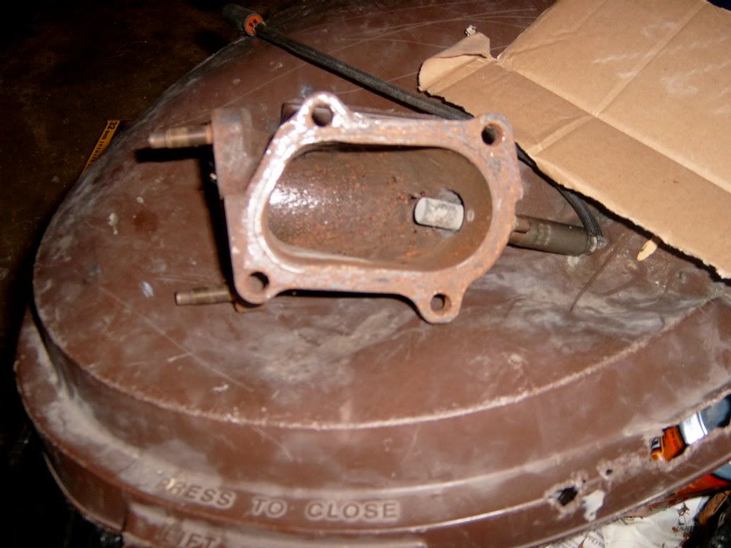

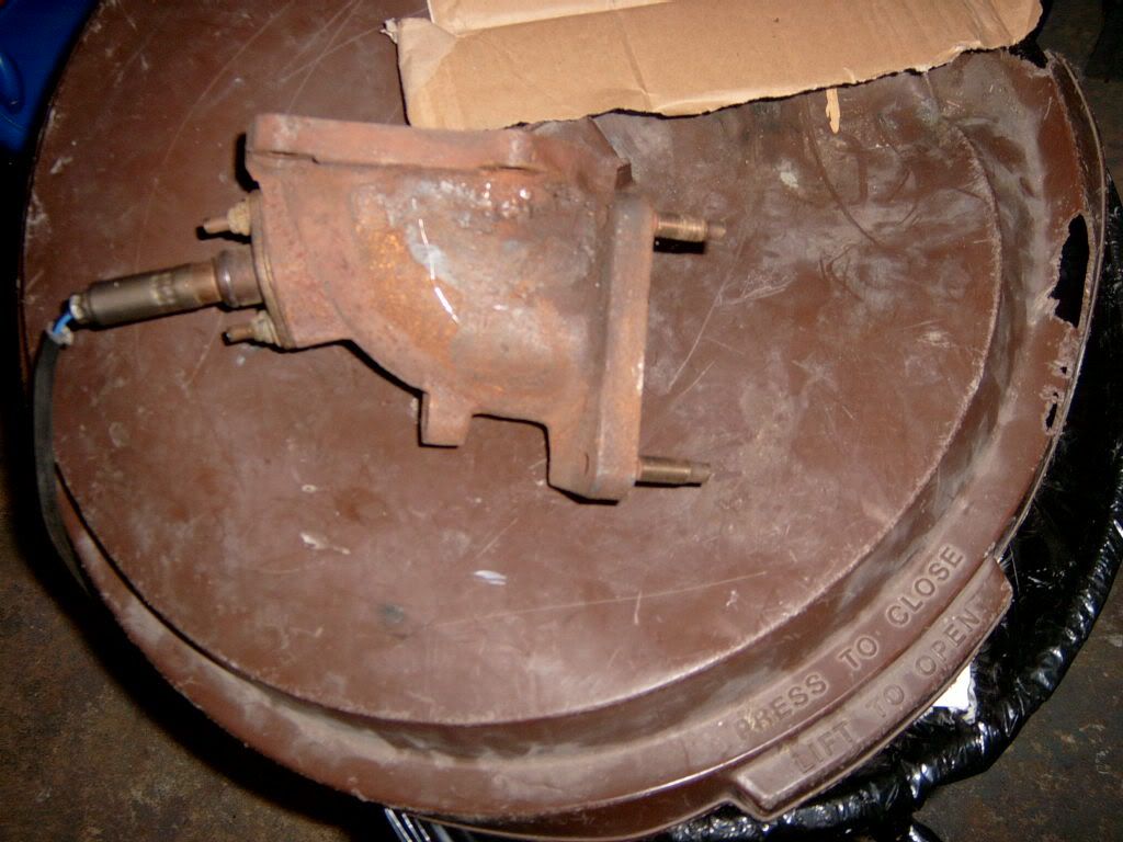

here is a ported stock elbow I had on my car way back about 3 years ago. Once you remove the "wall" you will be left with a hole on each side of the elbow that will need to be welded up.
That looks good! I didn't go that far down because it will cause a hole on the bottom...didn't want to deal with welding it up. ;)
QUOTE]
What holes? Im thinking of doing the same thing. How long did it take? If you got it done at a shop, how much did they charge?

For free it is a good idea. I did it because I have piles of car parts and full technician tool set. Mine looks like the one on the first page, not as big a port as the one on this page.
In terms of performance, just get a high flow elbow with your turbo, or the integrated elbow/pipe.
How much did it cost to get the welding done? What materials were used to weld the holes shut?
I just started with the gringder today and im half way done!!!

Well I finished it a bolted it up along with droping in a 89 NA intake cam and wow what a difference. Smoked a 5.0 from the line w/ 8 psi, turned up the boost and reved it and boosted to 10 psi (from the 3 lds I used to get unported ). Im happy, still want to get a suprasport to see what the difference is, but this will do in the mean time.

GreenChevelleSS said:
I hope your joking.
If not, then thats the way to be positive towards other peoples work. Dick...:3d_frown:
LOL sorry. Dunno, I'm usually not that harsh, but the wastegate gases are going to slam directly into a wall. At least on the elbow, they have ~1/2" before the wall goes up, but that's neither here nor there.
I agree it is good for X amount of years ago, and 3" full exhaust, yep. that's cool that it's only one piece turbo to tip.
