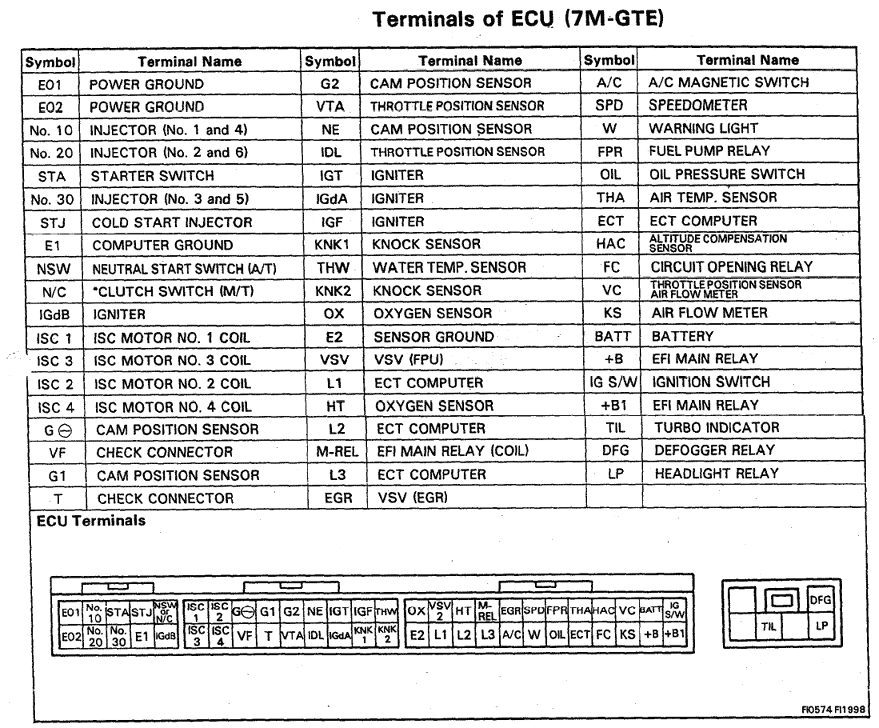

So... What you want is for someone to do a wire-by-wire diagram of which wire on the MoTeC goes to which pin on the factory ECU so that you can take the sockets off of the ECU board and make a jumper harness?
If so, it should be a matter of cross referencing an '87-'88 7M-GTE ECU pin diagram to the MoTeC pin diagram.
A quick google search turned up a pin diagram:

I'd do as hvyman said, and pin the connectors to a new harness.
If you just want to make a jumper harness though it should be doable. You'd have to de-solder the connectors from the board though. That's how these things are made.
As everyone has said, make a new harness as a standalone is going to need different sensors. Not to mention 20+ year old wiring and the issues that comes from it.

you're going to need to do this wire by wire... factory wiring layout seemed to change almost every singe year.... however wire color coding is pretty straightforward....
