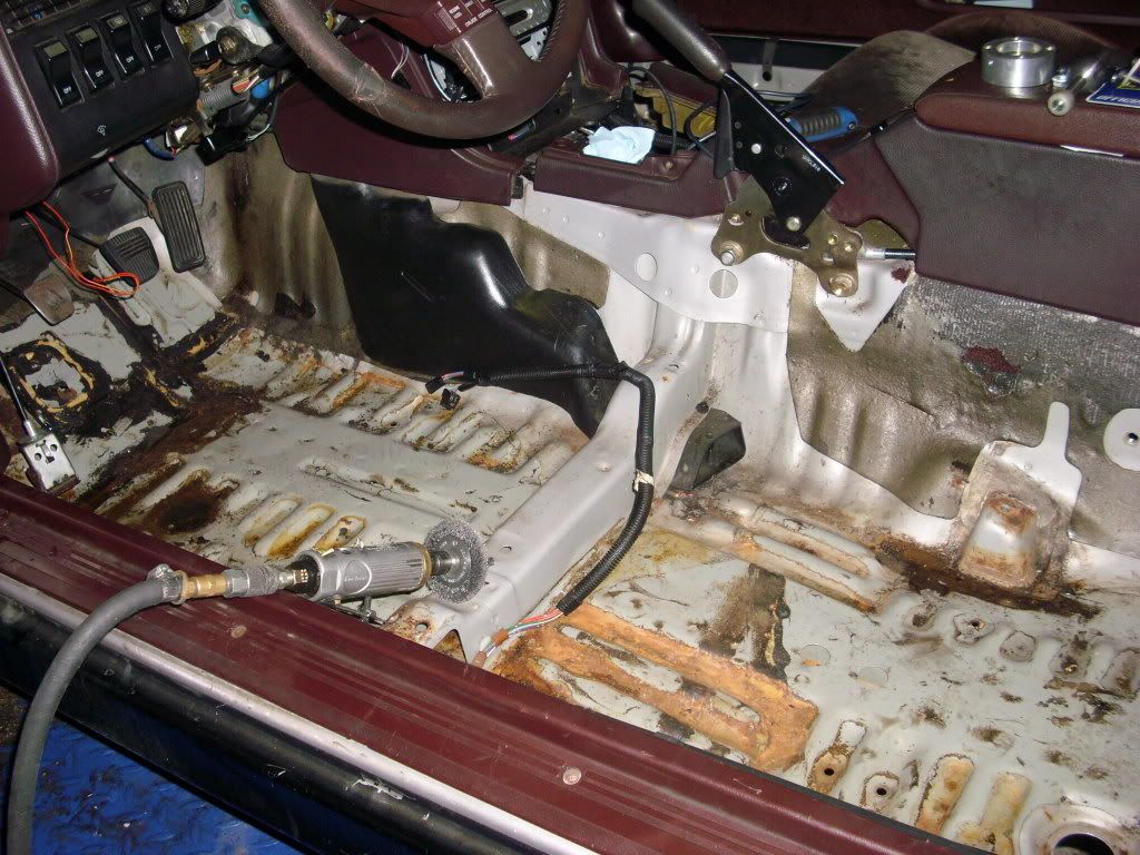

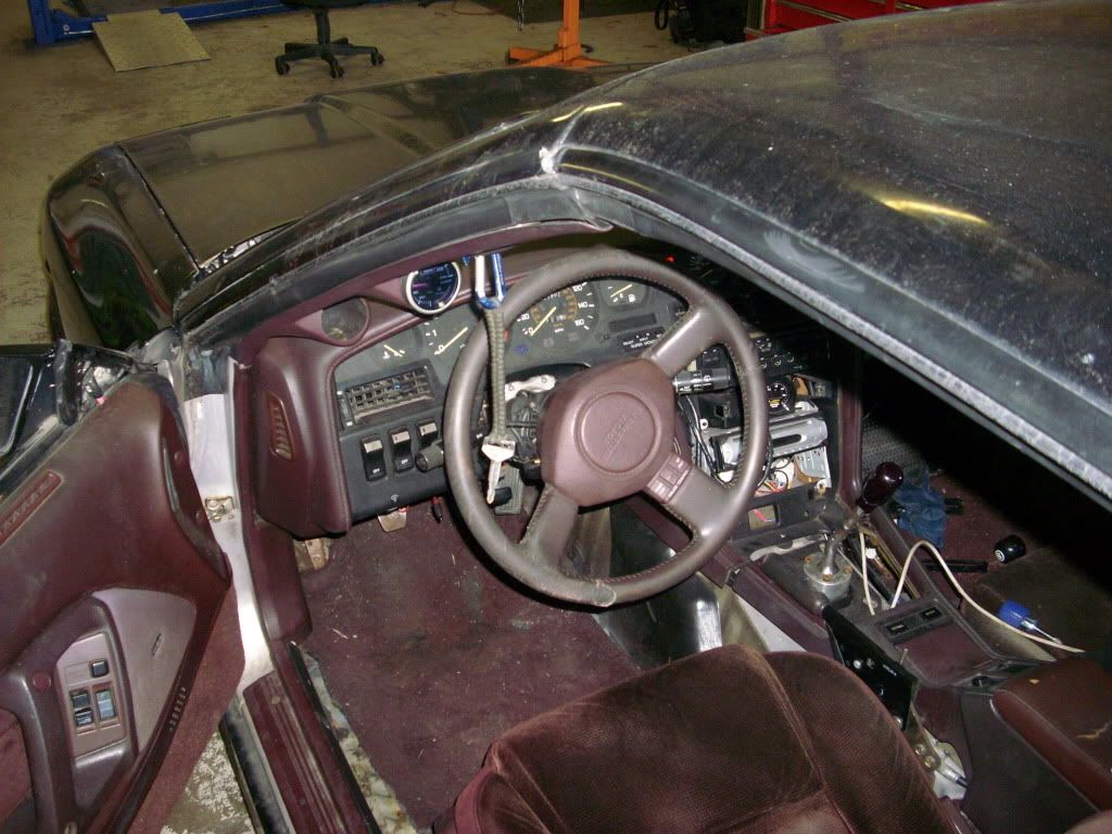

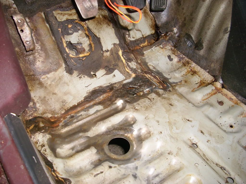

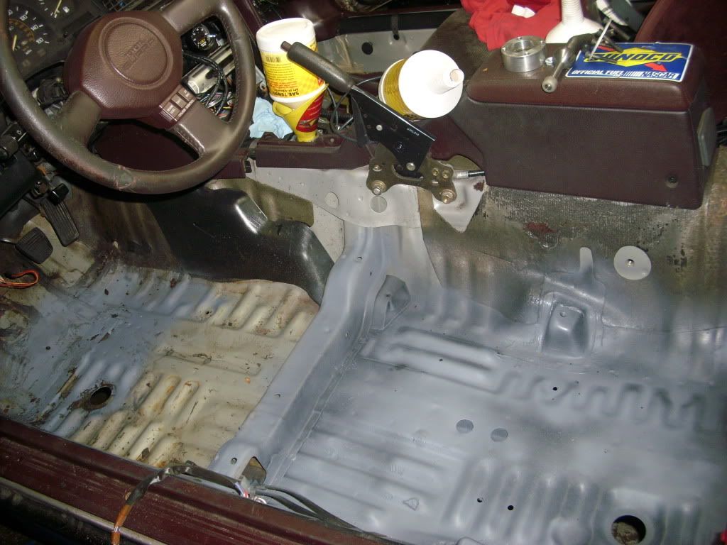

cars been down due to an electrical gremlin that i believe has been vanquished... long story short leaky targa seals not only pwne your interior &, rot your floor boards with cancer; They also have a way of messing up electrical connections... that being said, interior is removed and this track slut is getting caged sometime soon.

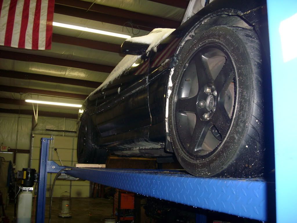

D2 coilovers at the highest ride height setting
...took out the carpet to run battery relocation kit and found the cancer
hopefully this does the trick...
just a temporary fix until i remove the dash and the cage gets welded in then i plan on going all the way back down to bare metal and spraying truck bed liner

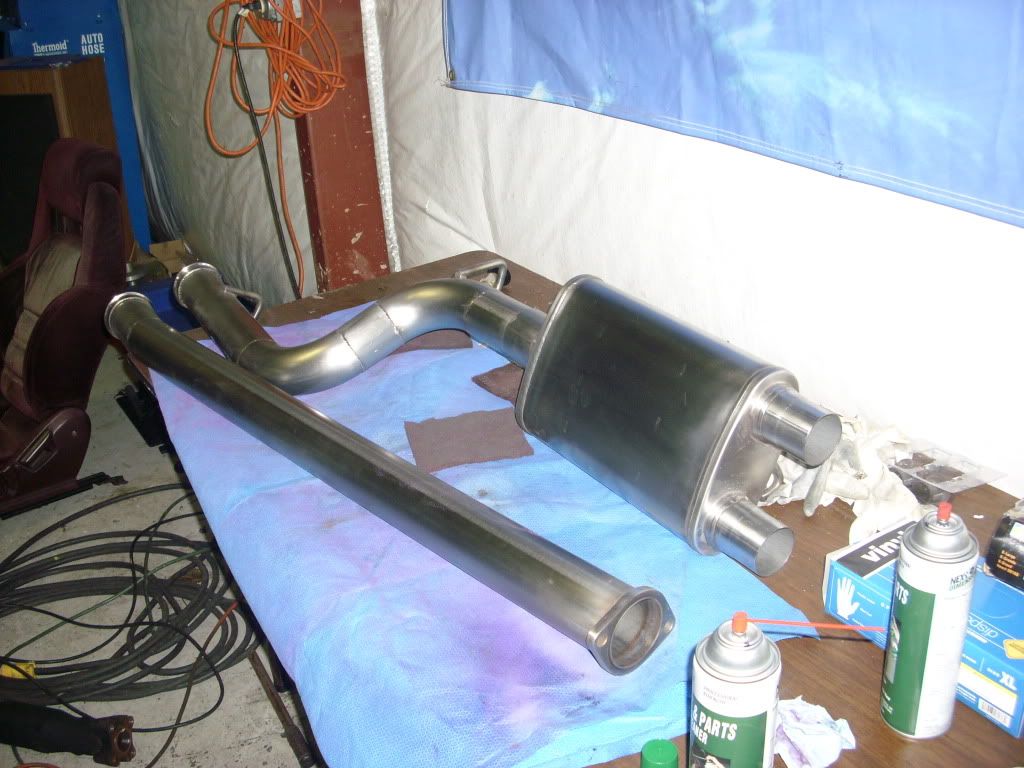

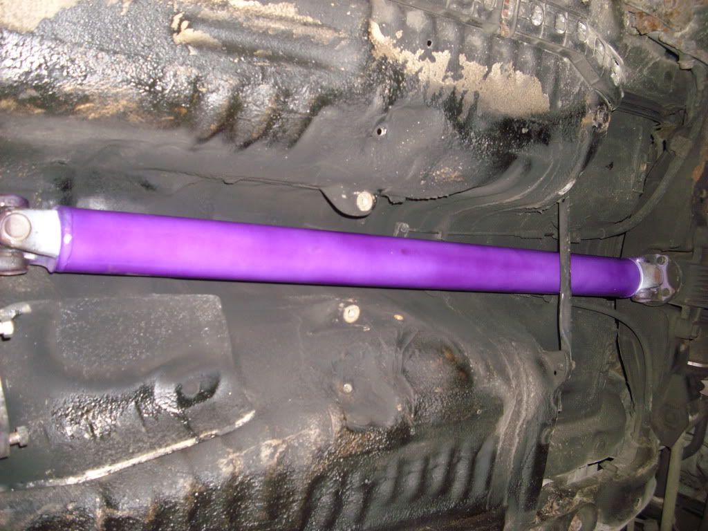

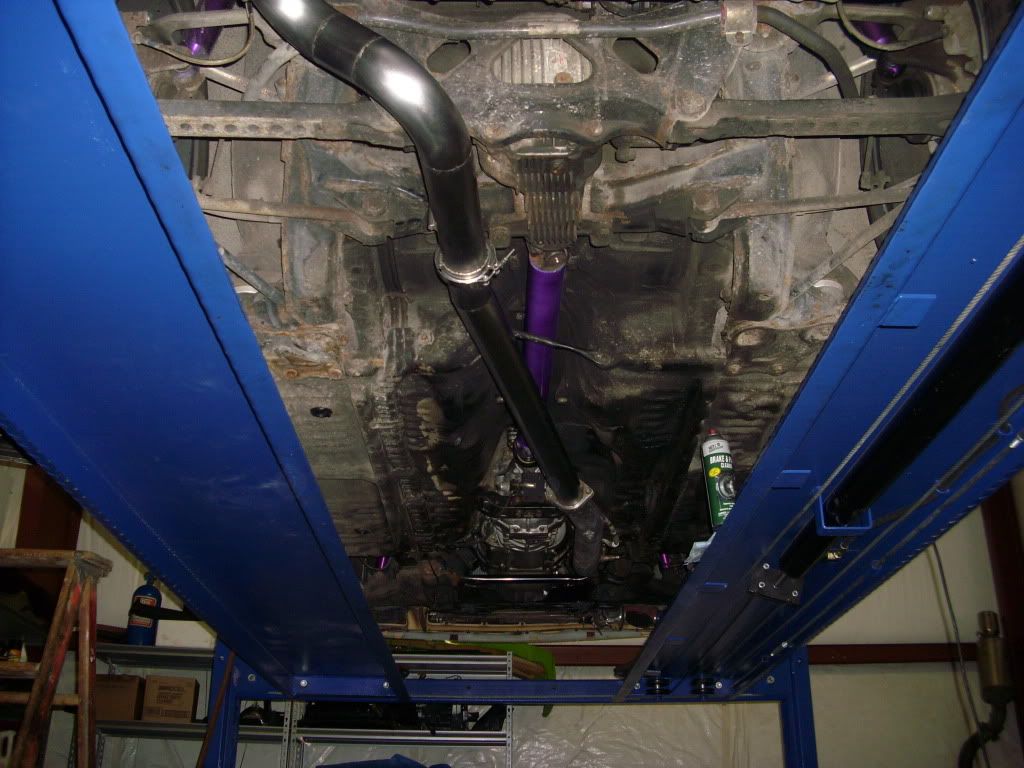

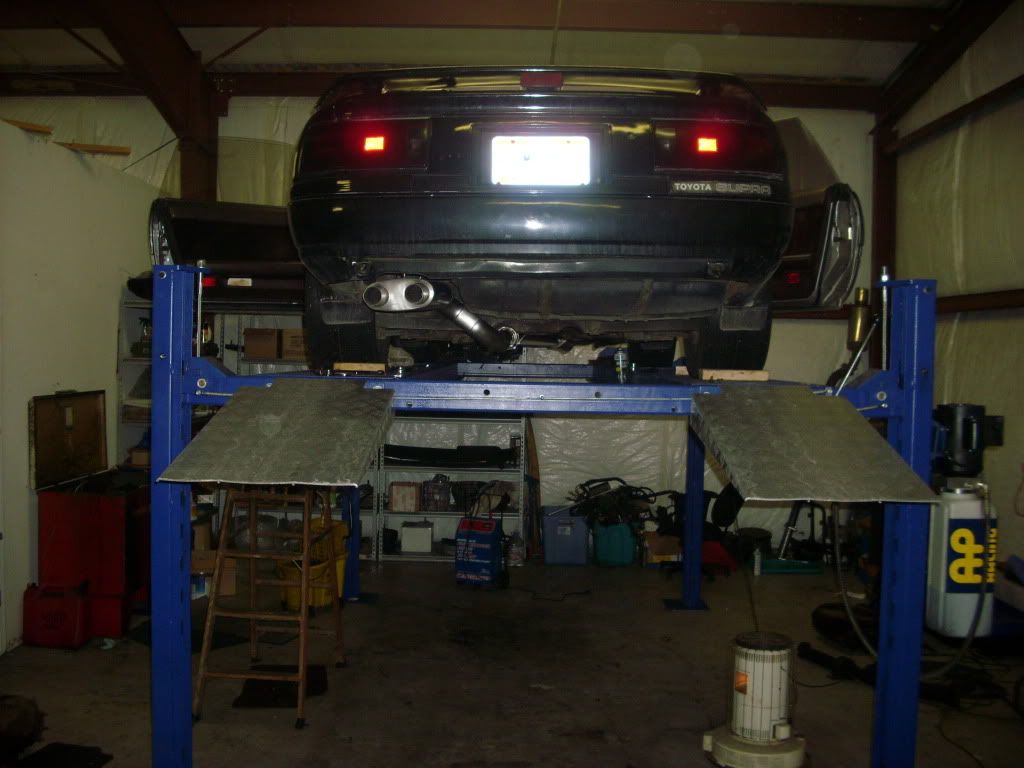

new shiny parts installed today...

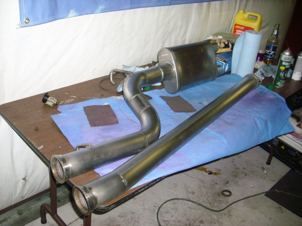

Beech Performance 3in ss dp back exhaust no test pipe required
1 piece drive shaft
never seen a purple drive shaft so i mad one,matches the coilovers nicely

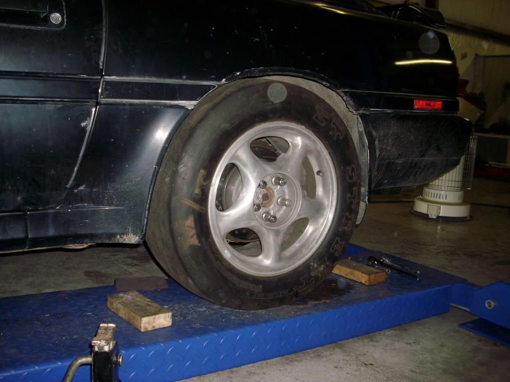

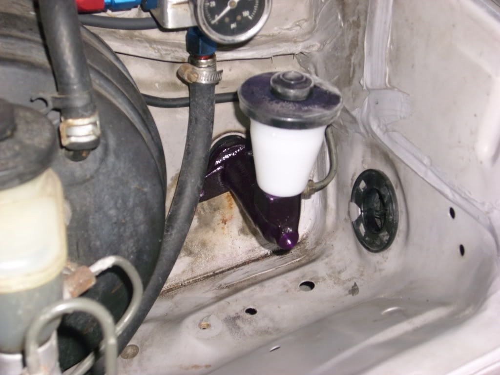

replaced the clutch master after adding my personal touch

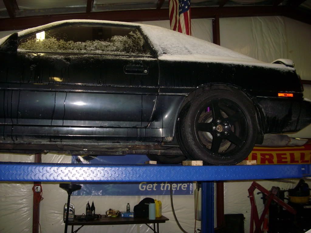

test fitted the M/T et streets to see if my fenders needed rolled, definatly gonna be an issue if i lower the rear later on
much later on that night i tossed some old sawblades on the rear and pumped em up to 45psi, good 30sec burnout in 10*F temps gotta love it... vid link in my sig

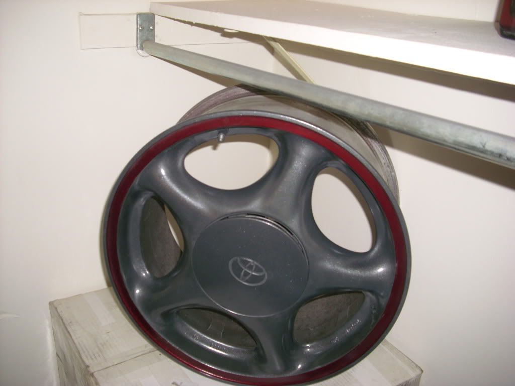

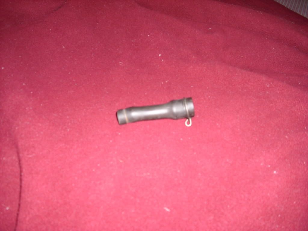

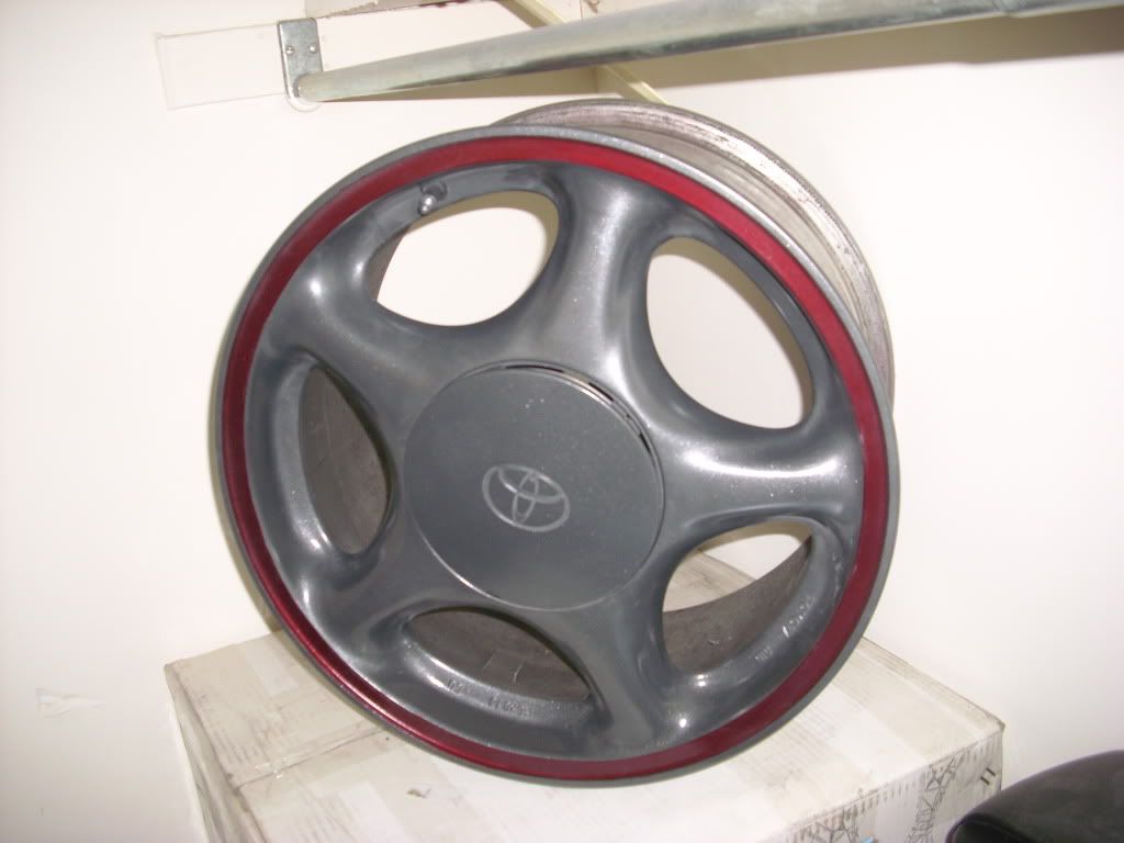

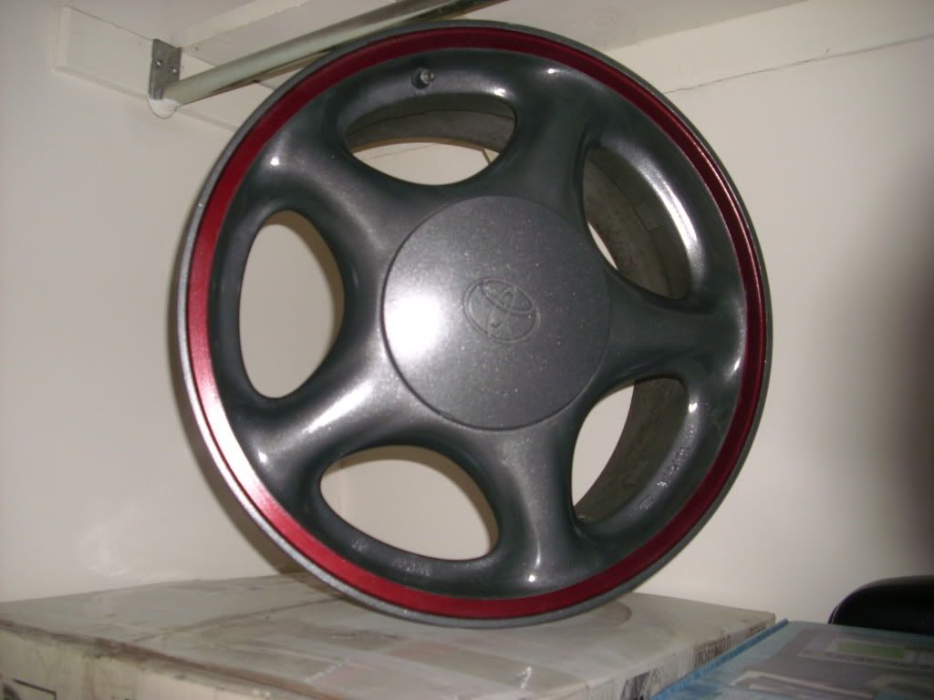

Thinking about putting these up for sale for awhile... figured id try and gauge interest in 5 MKIV N/A rims, no rubber...
Also have an extra double din radio bracket...

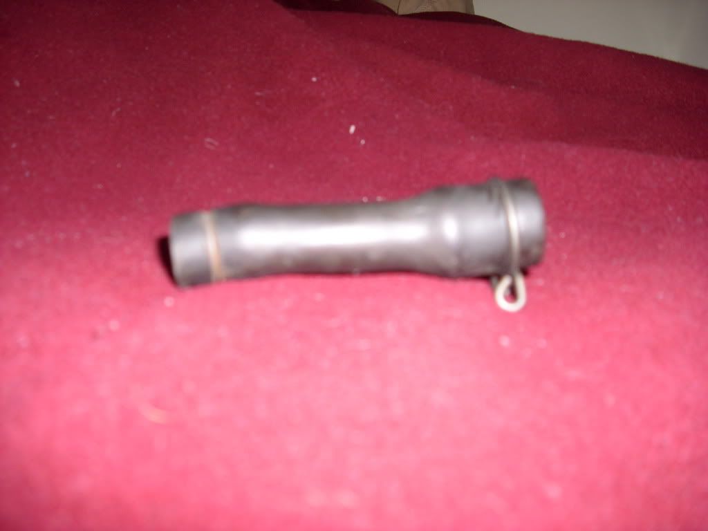

And this 7M upper hose...
rubber is still soft, no cracks
iĺl have prices and pmnt information when i hit 50 posts in a few seconds...

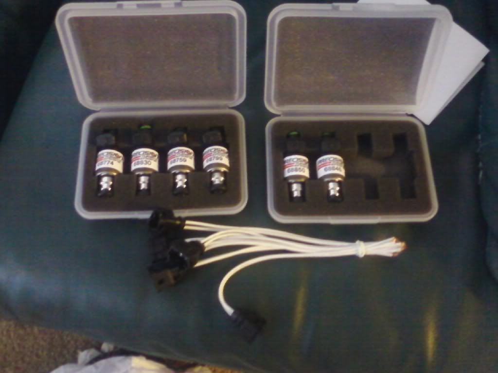

sold my RC 550cc inj and maft pro....
1000cc PTE installed, should get the job done for awile

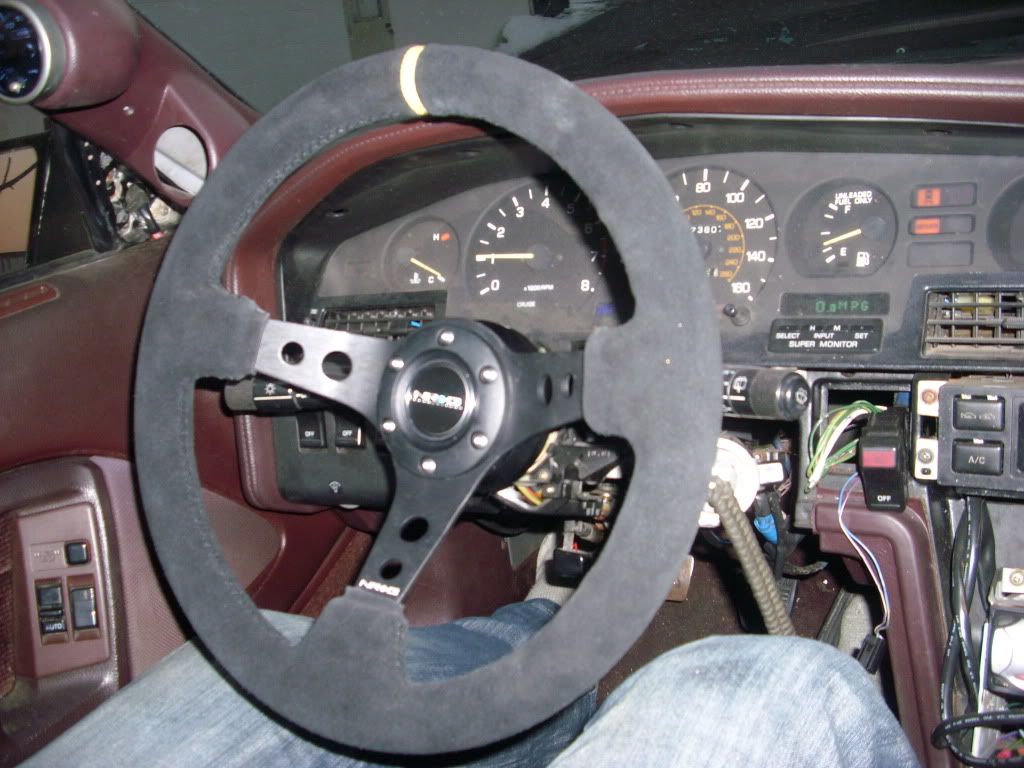

Next i decided my interior could use some attention...

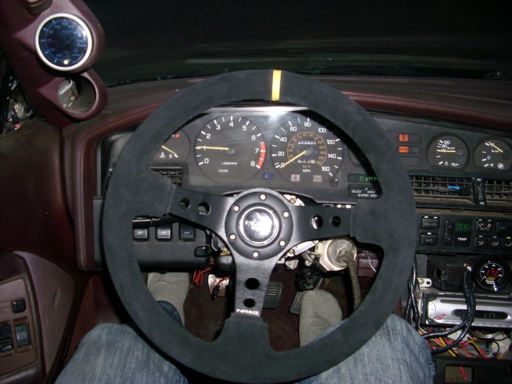

who the hell @ yota thought burgundy was a good idea? i mean seriously...
time to ditch the school bus style steering wheel, again yota wtf?
1.5 in nrg short hub adapter
and 350mm nrg 3 in deep dish suede with black stitch. got the hub and wheel from grimsta on here. Ace is a top notch seller and i will be doing business with him again. everything sits about exactly were the factory wheel was, but looks and feels 100x better.
quality is remarkable for what i paid. hub is billet and power coated, wheel is stitched up uniformly and even... couldn´t ask for more keep up the good work nrg!!!

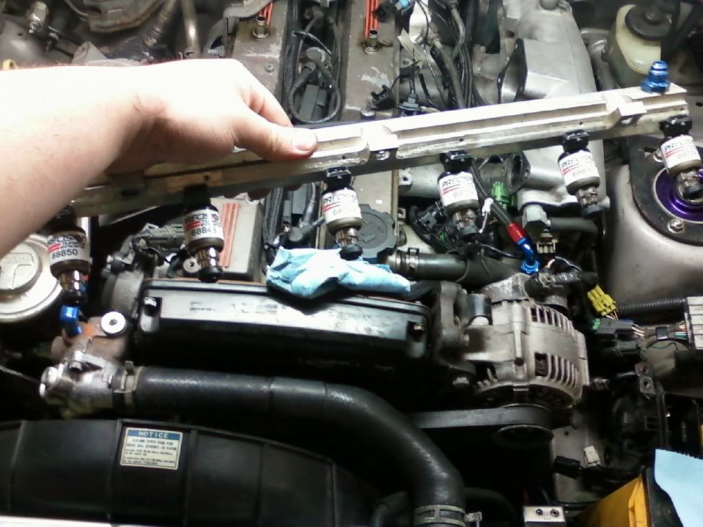

next on the list it some good old fashioned bro tuning... the injector tables were all set and dialled in on 550cc now its running on 1000cc note the wideband shot in that last picture. the tune needs reworked before i can cruse around past just moving the car in and out of the shop.

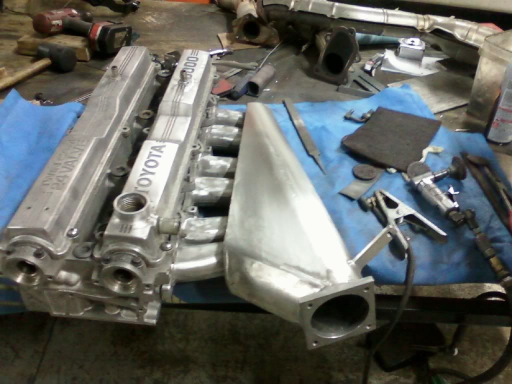

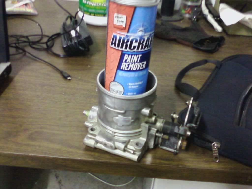

been wasting alot of time grinding down the welds and im kicking myself for not taking a before shot but heres my progress. scotch brite it amazing, but those scotch brite pneumatic grinder cookies are FTFTW!!!
and heres a quiz... other than the tps, what is all missing on this q45?

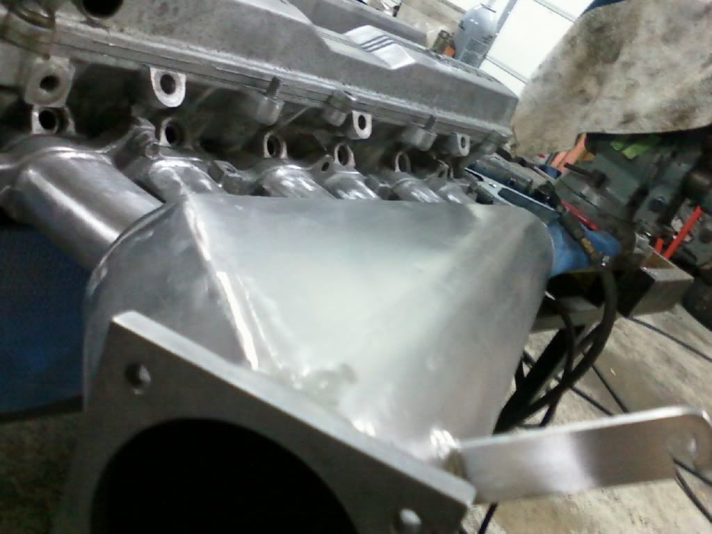

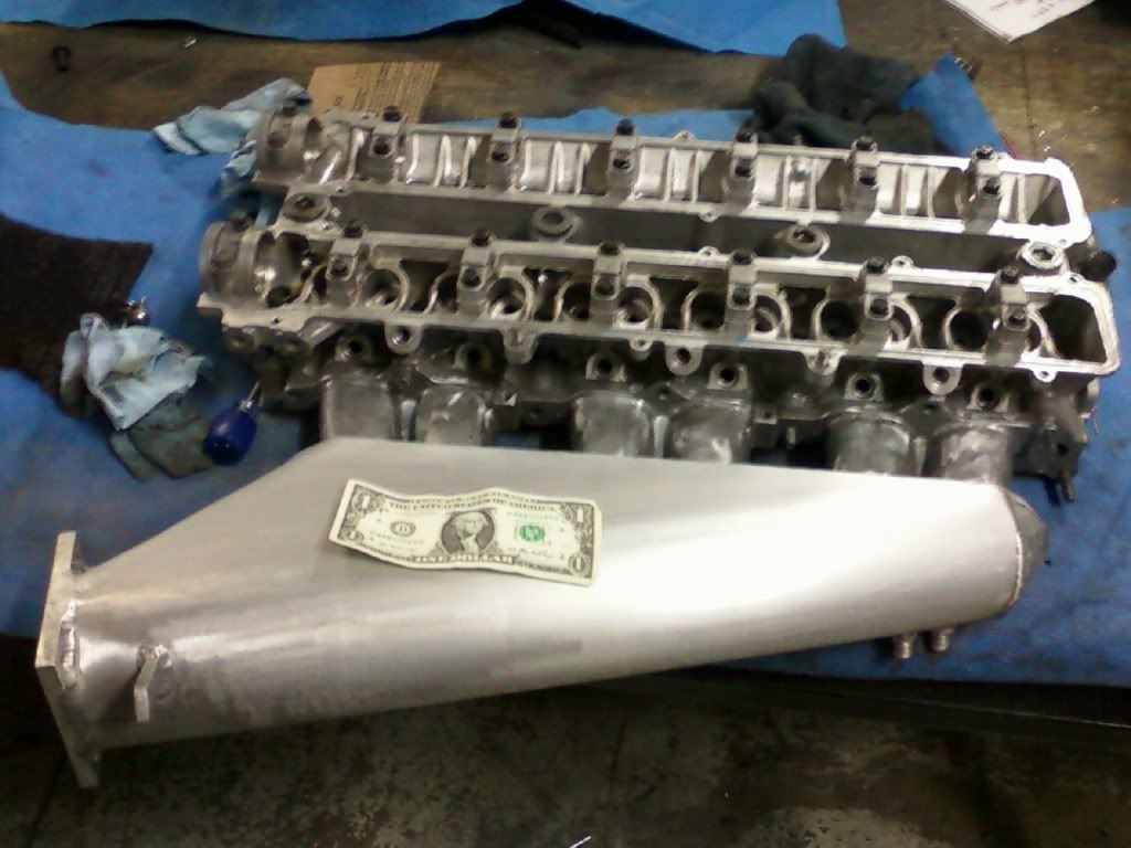

wesss beech, made it afew years ago... he has sense then gone with the long runner design.
hes made quite afew parts on this car, hopefully more to come
