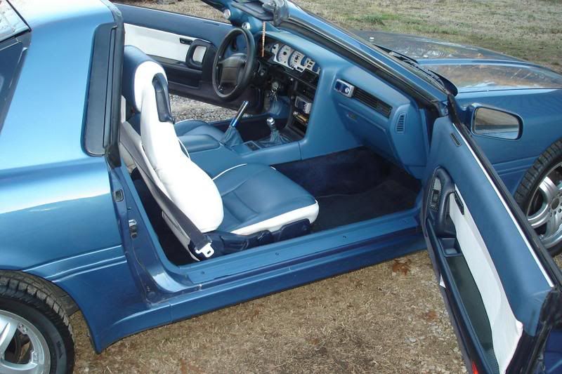

When Jay (suprahero) and I did his interior we used scotchbrite pads to scuff it up. Then we just used a cleaner degreaser to prep, followed by a tach cloth. Then we just had dupont base mixed to the color he wanted and I shot it with my hvlp and we called it a day. Here is a picture!!!
Jay has had no problems that I know and it has held up very well over the last year.
Im sure you can do the same with spray cans, just have Napa put your color of choice into cans for you.:icon_bigg
