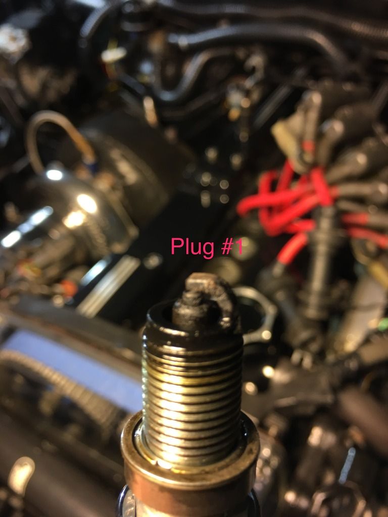

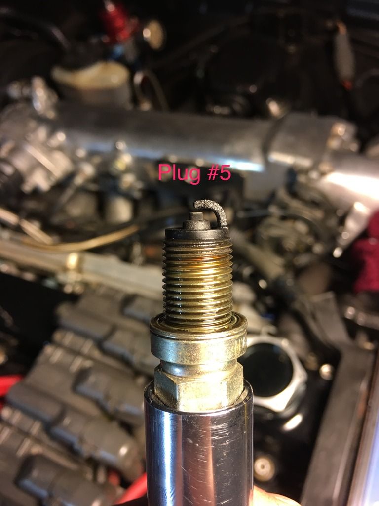

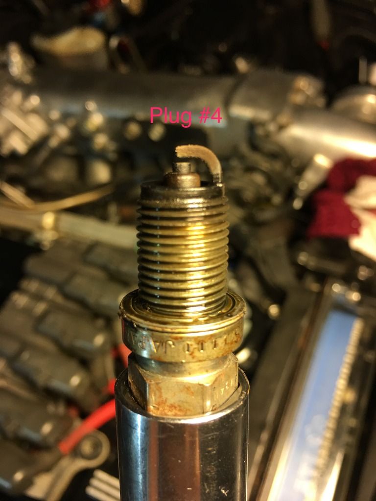

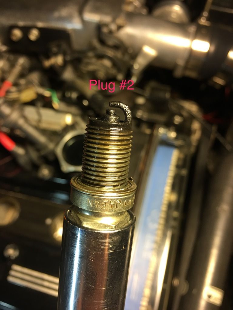

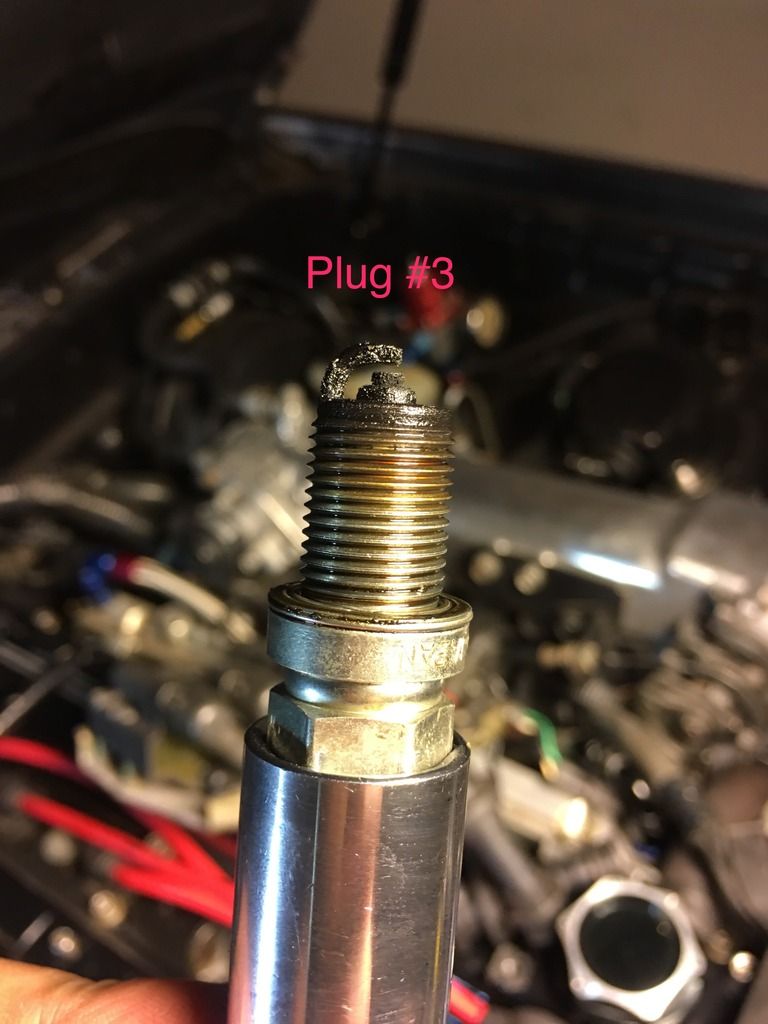

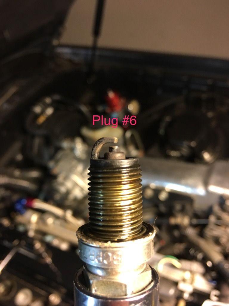

Here are pics of each spark plug upon removal (less than 200 miles on them):
The top of the pistons are all black and shiny (basically caked with carbon and oil). I'm surprised that the plugs don't foul and misfire, but the engine actually runs great. So what's more likely, split valve stem seals or excessive crankcase pressure?
