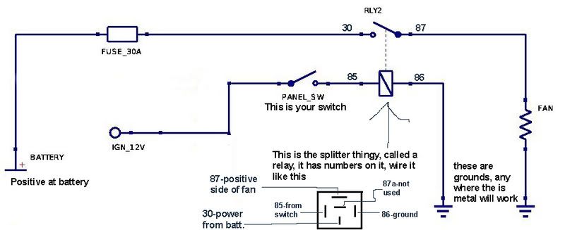

soundwave2000 said:
Hope this is easier to understand
So with this splicing thing, all I need to do is splice the red wire and connect it to 85? I did everything else, all I had was the wire from the toggle switch connecting to 85. So after I splice the red wire, I just connect it to 85 and it should work?

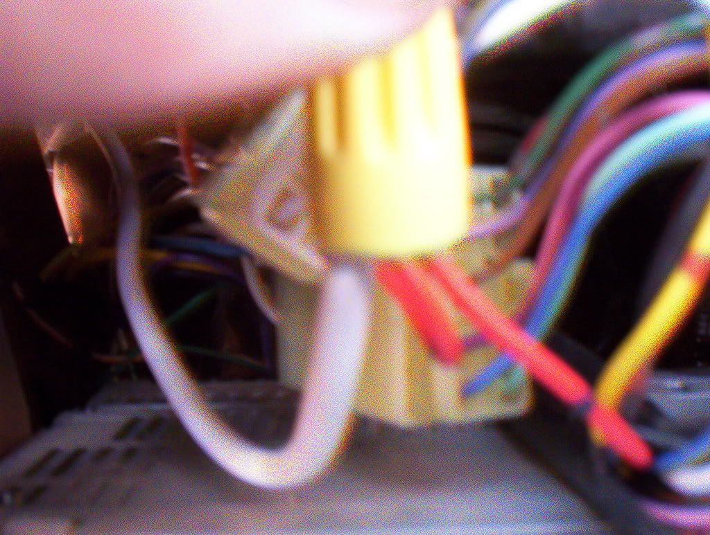

my nice "splicing" job lol, the radio still works so I must have done something right. The white wire runs out through my firewall and I connected it to 85. Is that correct?

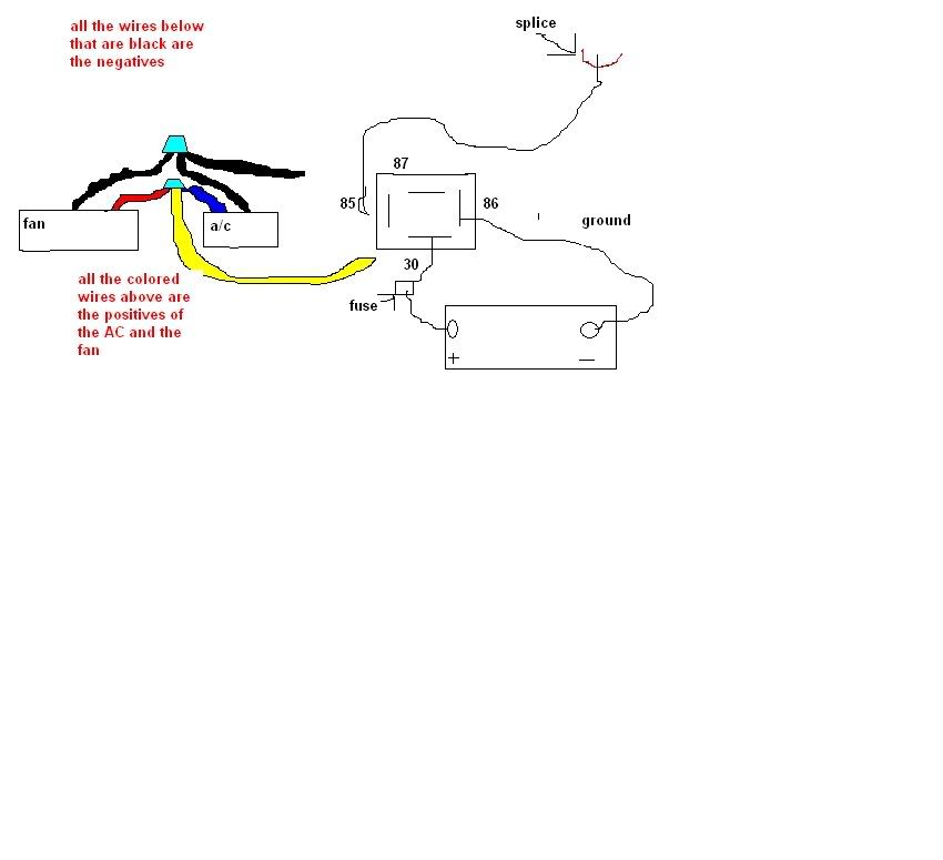

Here is how I wired the fan and stuff, (drawn on paint :aigo: ) after everything hooked up...the fan still doesn't work. I don't know what to do now :cry:
When I took it to the dealership awhile ago they said the fan worked. So I'm at a loss...bad wire some where? Should I replace all the wires and start new?

Nice diagram, it helps. I see there is some wire going to the ac? Do you still have the stock ac fans? brand of fan? Post a pic of the fans you are running and the wires attached to them....and one shot probably from driver side fender looking towards front of car for a all in one shot.
I will get SW to look at your diagram but I bet hes going to tell you the ac set up is the flaw...just a guess.

Ill give you 5 dollars for tha car. If not, forget the ac is there when wiring your fan, the small ac fan should remain hooked up to the factory wires. Just wire your aftermarket fan by itself like I showed. if it still no worky, start replacing wires, or hook you fans positive to the batt for a sec to see it it still lives.
