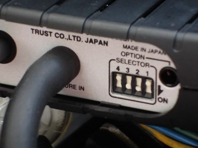

polobai said:
no luck on the wastegate issue above?
I also have a profec-B with a tial 38mm. When it stops raining, if ever. I'll go outside and double check for you to make sure you don't have them reversed. Did you double check the dip switches settings in the back of the unit as well?
polobai
Apr 1, 2005
662
Orlampa
hey, you may be correct-I had the unit working with the 57 trim ct 26 before (internal wastegate)-I wonder if the dip switches have to be different for an external setup....if you or anyone can get me a diagram of how the dip swithes and vacume hoses are setup on their car, I would really appreciate it.
turbogate
Life is Boost
May 18, 2005
425
South, FL
I just checked my set-up for you. The Profec B actuator IN line is the one connected to my Tial "Side" port and also Teed to the compresor housing. The OUT goes to the top of the wastegate. If you have it set-up this way, then most likely the dip switch settings, if you are now running an external wastegate, I'm pretty sure the settings are different. Mine works wonderfully. Hope that helps. By the way, I have the older type Profec-B, the one with the turn dials, if you dont have your manual anymore, I can tell you what my dip switch settings are.
Lastly, keep up the good work.
turbogate
Life is Boost
May 18, 2005
425
South, FL
Here's my setting. Thats for external wastegate, there's also a second external setting when overboost occurs.

polobai
Apr 1, 2005
662
Orlampa
man, thanks alot-you are the man! I also have the profec b spec 1-I am going to check on the settings and how I have the wastegate setup and let you know-thanks so much!
polobai
Apr 1, 2005
662
Orlampa
you were right-my dip switches were set for an internal wastegate-switched them up and it works great! Thanks for the assistance!
