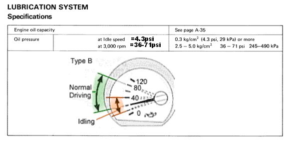

TSRM spec's pressure at 4.3 psi or greater at idle...it's 36-71 psi at 3000 RPM.
http://www.cygnusx1.net/supra/Library/TSRM/MK3/manual.aspx?Section=LU&P=4
The rule of thumb is 10 psi for each 1000 RPM above idle. The 7M-GTE has a pressure relief valve set at ~40 psi for the oil cooler circuit that limits pressure above that.
