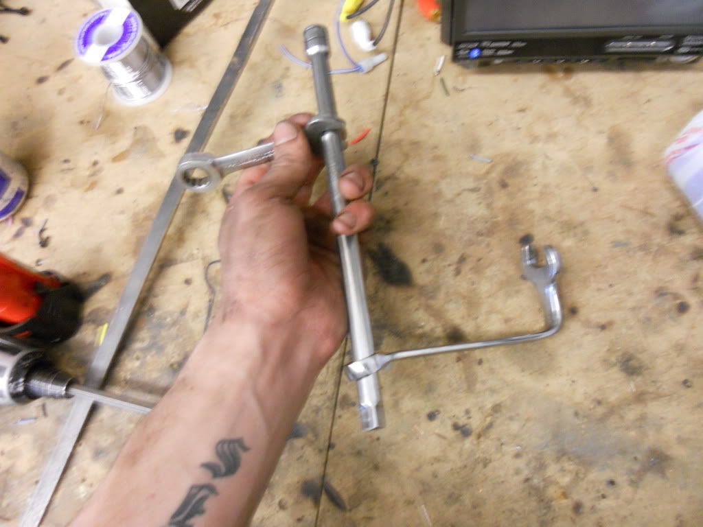

Ok, so after searching here and google, i've devised my question. Do you need to leave the stock oil pressure sending unit wire intact, and then tie into it with the aftermarket gauge? or can you just cut the wire and attach the aftermarket gauge to it? or do i NEED to use the aftermarket sending unit? i am asking this because i installed a new OP gauge and while driving it stays at 45ish psi. thats it...and below 1800rpms it starts to freak out, jumping all over the place. and while stopped it pins at full pressure, as if it were not hooked up. and sometimes while just sitting at idle it will jump around. the stock gauge never did anything so i figured it was the sending unit, but i went with a new gauge and unit too. but after an hour of trying to get the stock sender out, to no avail, i just tried hooking the gauge to the stock sender, and it seemed to be working...now im not sure. if it comes down to it ill just try again to install the new sending unit. but there is NO room to get to it. so id like to know how others have hooked up their aftermarket OP gauges. thanks
