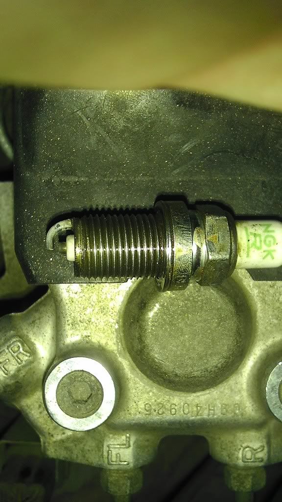

What does this mean? should i be worried?
It was a ggod amount but not enough to soak the whole head it was only on that plug none of the others..The head is still pretty clen inside so i dont think it is the vavle cover gasket but it could be.
Reason i changed them was because the car was missing through full throttle pulls (problem fixed :) )
Old ones where 6 heat index NGK's gapped to .38 when i took them out.
new ones are NGK BK7RE's gapped to .28

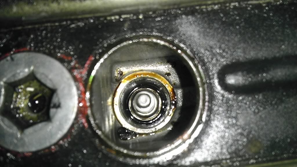

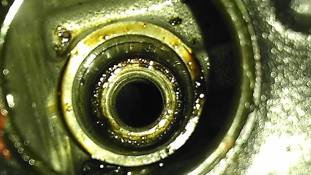

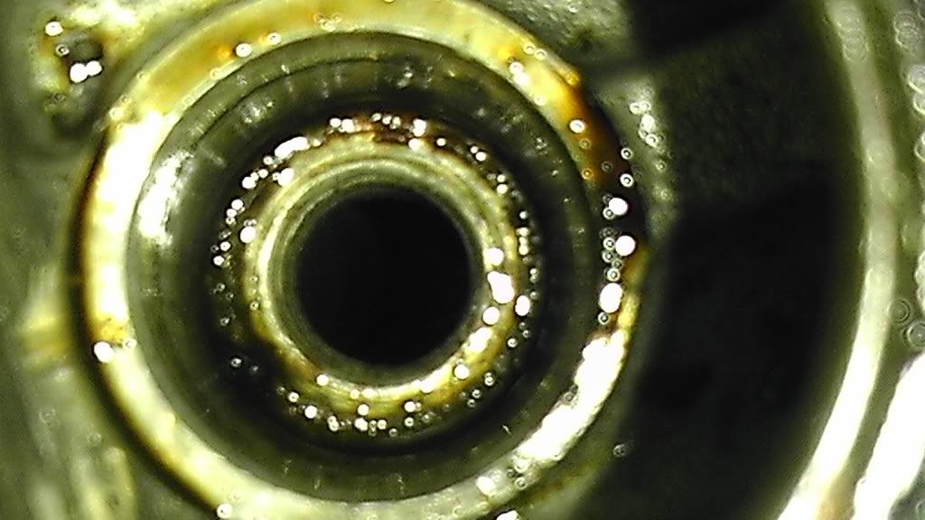

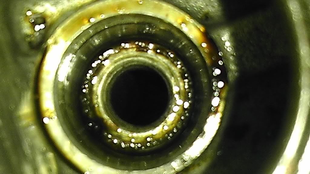

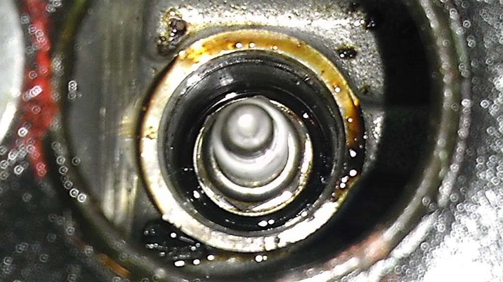

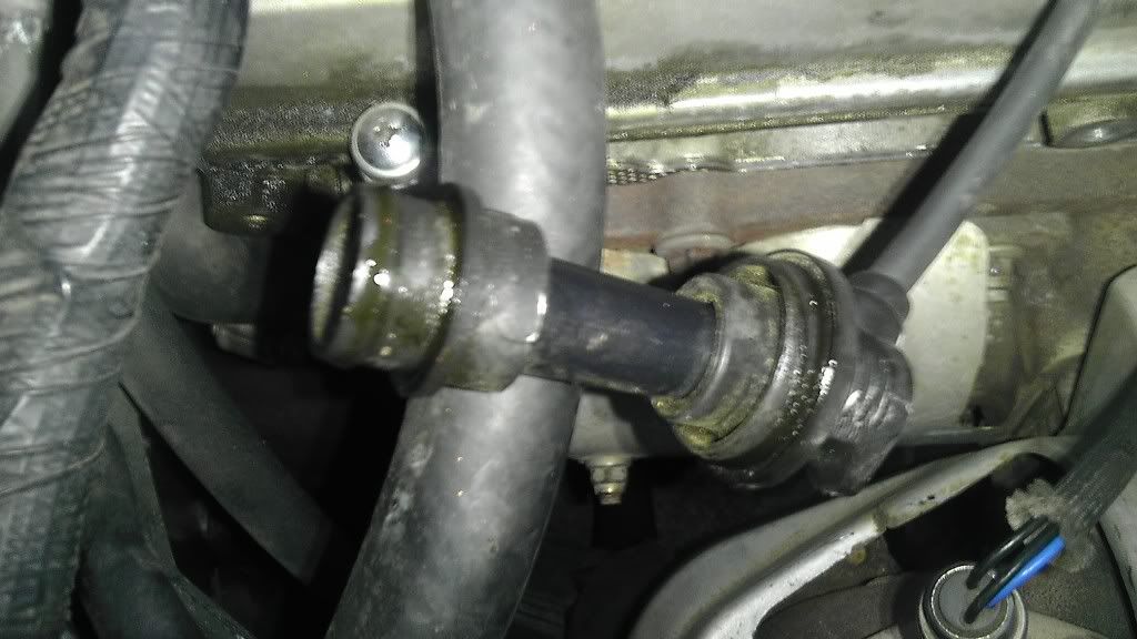

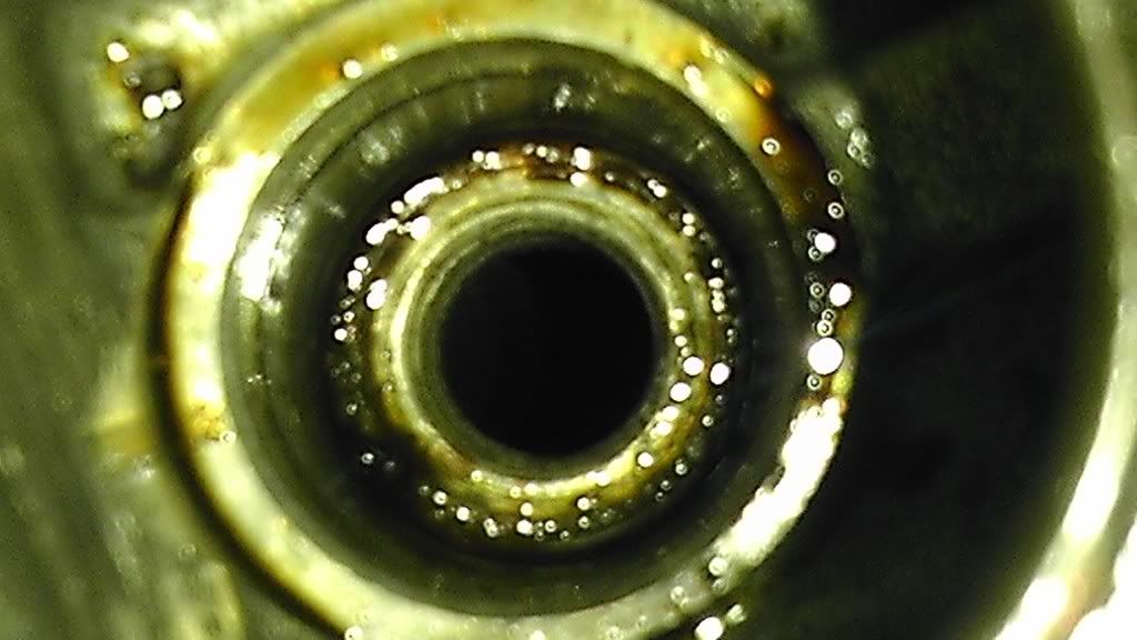

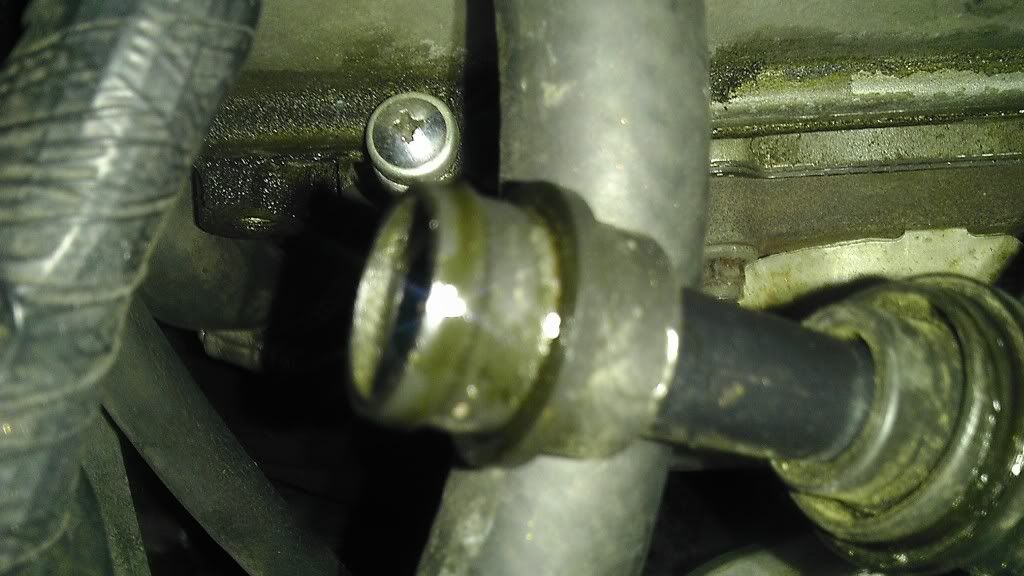

Ok so here are some pictures. good news is it seems to just be valve cover gaskets butim still burning enough oil to blow out smoke those few times. but im running pretty rich.
it looked abit worse yesterday but as i said i just did the plugs so. its only the Number 6 plug

You sure the oil is not dripping onto the plug when you pull it out?
Looks like either of the 3 valve cover gaskets.

No. 3 valve cover gasket. Leaks oil into where your plug goes then when you pull the wire off and then pull the plug out it runs down into the cylinder causing it two smoke that oil off the first bit of driving. That's my experience anyway hopefully it helps

If your burning oil on cold start ups its the valve stem seals.
The oil getting into the spark plug valley is the no3 valve covers. There is a napa part number for drain plug seals that seal it up nice. You just remove the black no3 valve cover after. As long as the wires are good they will stay on the plugs plenty fine.
Its likely both problems just happened at once. Its the way the 7m likes to work to some people.
