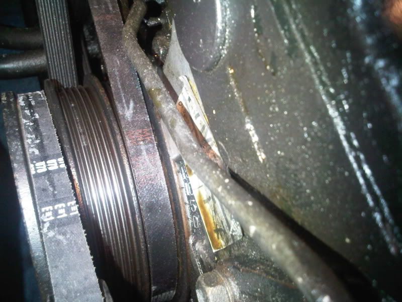

this is a picture of kinda where its coming from. took off the timing cover (plastic thing) and couldnt tell where it was leaking. Possible its leaking behind the metal plate behind the cam gears coming from the cam seals?
my water pump also has oil on it. My thought is the revulutions of the engine is splatering all the oil up there? but i also cant find it!!!!

Yeah mine was soaked all over exactly like that picture, and my fan was full of it slinging it everywhere in the engine bay. I would do the cam seals, they're $15 tops each.
