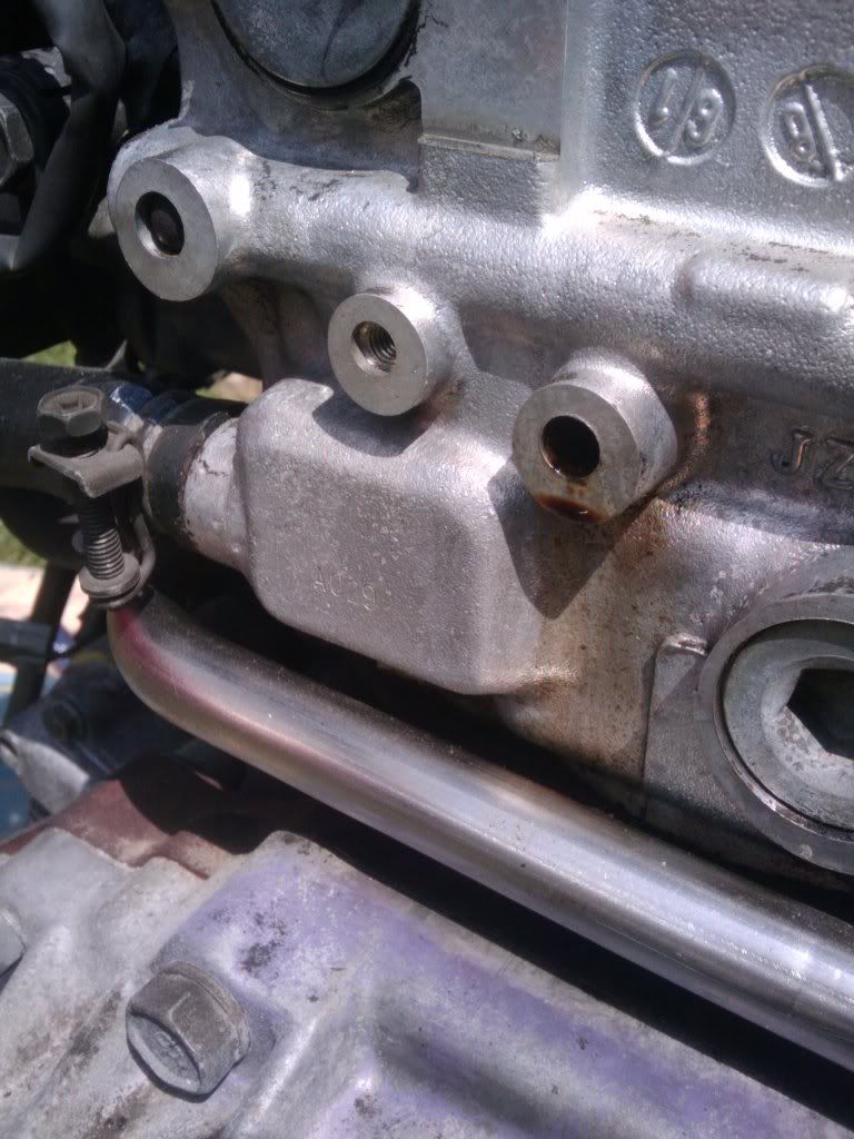

Can anyone tell me why is oil coming out from here?? and how can i stop it
A A32Boost New Member Feb 9, 2010 124 0 0 Philadelphia, Pennsylvania, United States Aug 8, 2010 #1 Can anyone tell me why is oil coming out from here?? and how can i stop it
Poodles I play with fire Jul 22, 2006 16,757 0 0 42 Fort Worth, TX Aug 8, 2010 #2 That's the drain for the spark plug wells. More than likely the cam covers are leaking.
A A32Boost New Member Feb 9, 2010 124 0 0 Philadelphia, Pennsylvania, United States Aug 8, 2010 #3 so just leave it as is and change the valve cover gaskets?
OneJArpus Supramania Contributor Jul 1, 2005 2,798 0 0 40 Newark, New Jersey, United States Aug 8, 2010 #4 yup!, but clean the galley so you don't have oil continuesly pouring out that is left in the valley.
A A32Boost New Member Feb 9, 2010 124 0 0 Philadelphia, Pennsylvania, United States Aug 8, 2010 #5 oh ok thanks
