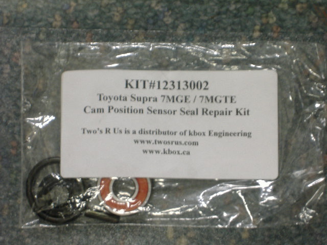

Is this what I need, will it work in the dist?
http://www.twosrus.com/catalog/prod...id=66&osCsid=6bec8e0ccd13a73f4366341e6e149624

Got the dist and it looks fine.
At local repair shop that sells Beck Arnley parts, the part listed at $400.
I seen it online for around $200.
How is it that it can be sold for $55?
