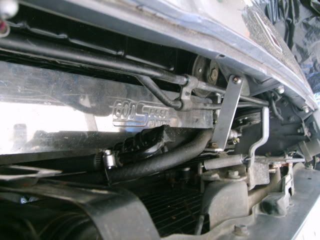

If you want to get by on a budget you can do what I first did, before I upgraded my system.
I drilled a hole in the center of the mounting flange and hung it in front of the hood lock. Then just pick your self up some 3/8" fuel line (like .75 cents a foot) to reach the new mounting location.
This is the only pic I can find of my old setup.
