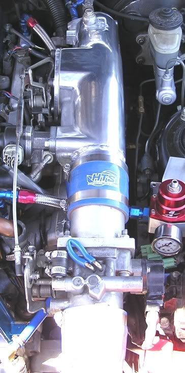

Can't figure out why go with the stock TB when a custom CNCed TB can be had for $150 or less and be an upgrade in size and look! Especially when you are welding a new flange on anyways and are you both following my steps?

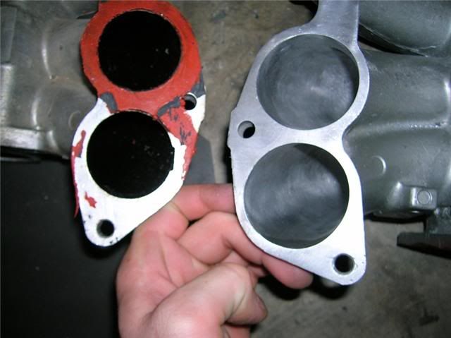

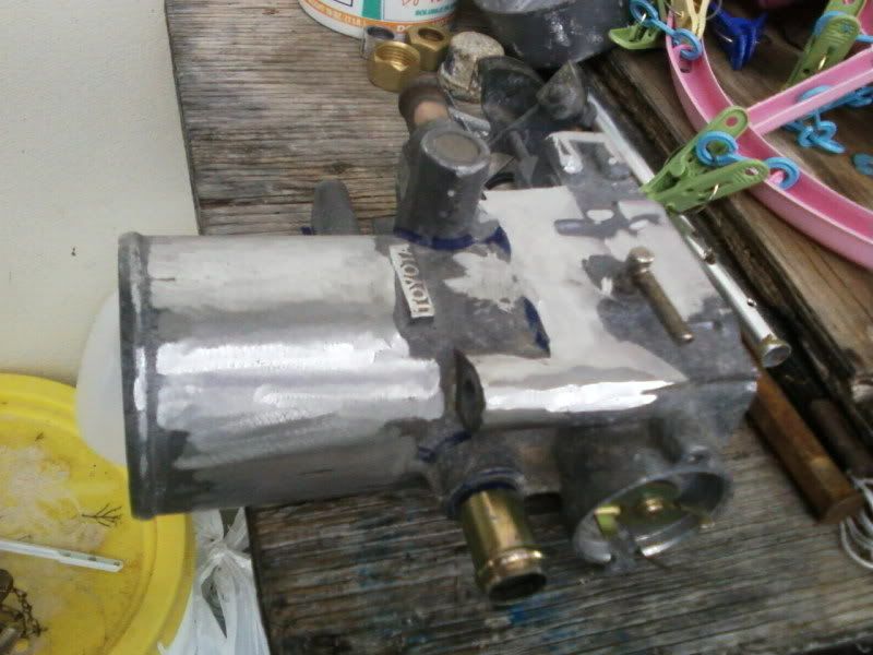

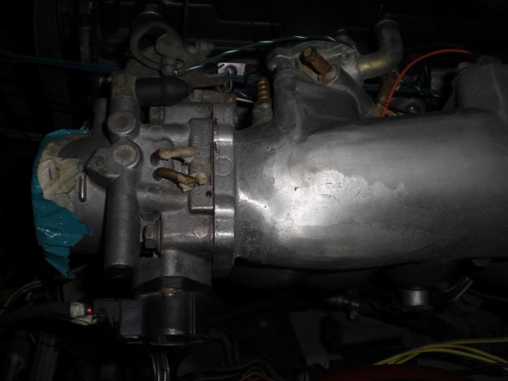

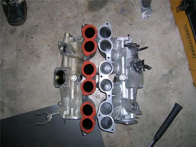

Here are a few old pics of what mine looks like, I was goin for a factory type look.
Added material to keep good flow to all runners
Also ported and polished the runners upper and lower
I was just tryin to clean up the general look of the TB and manifold by removing to stuff i wont use/need.

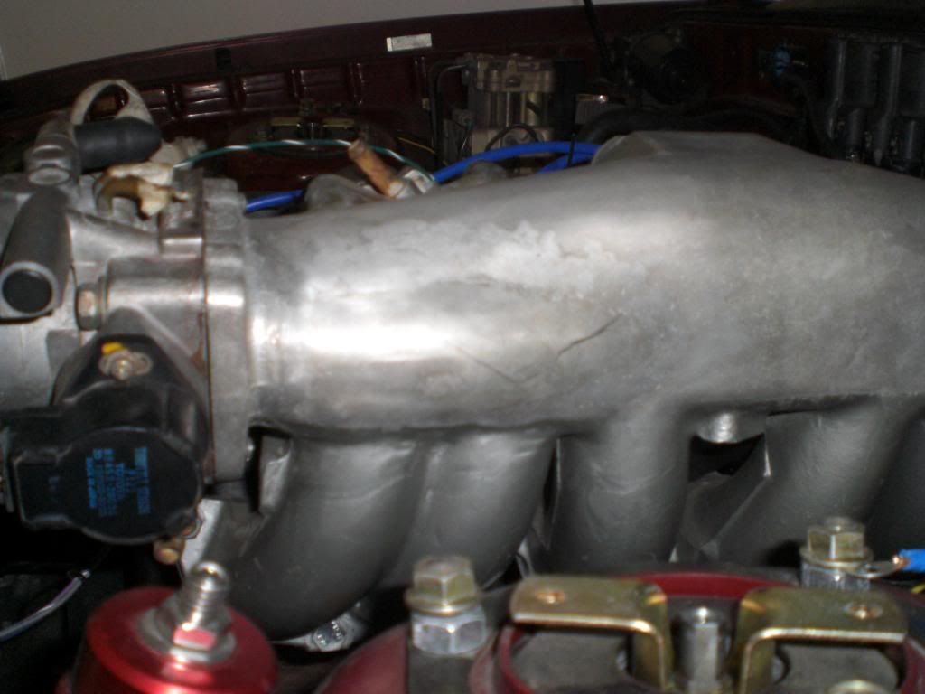

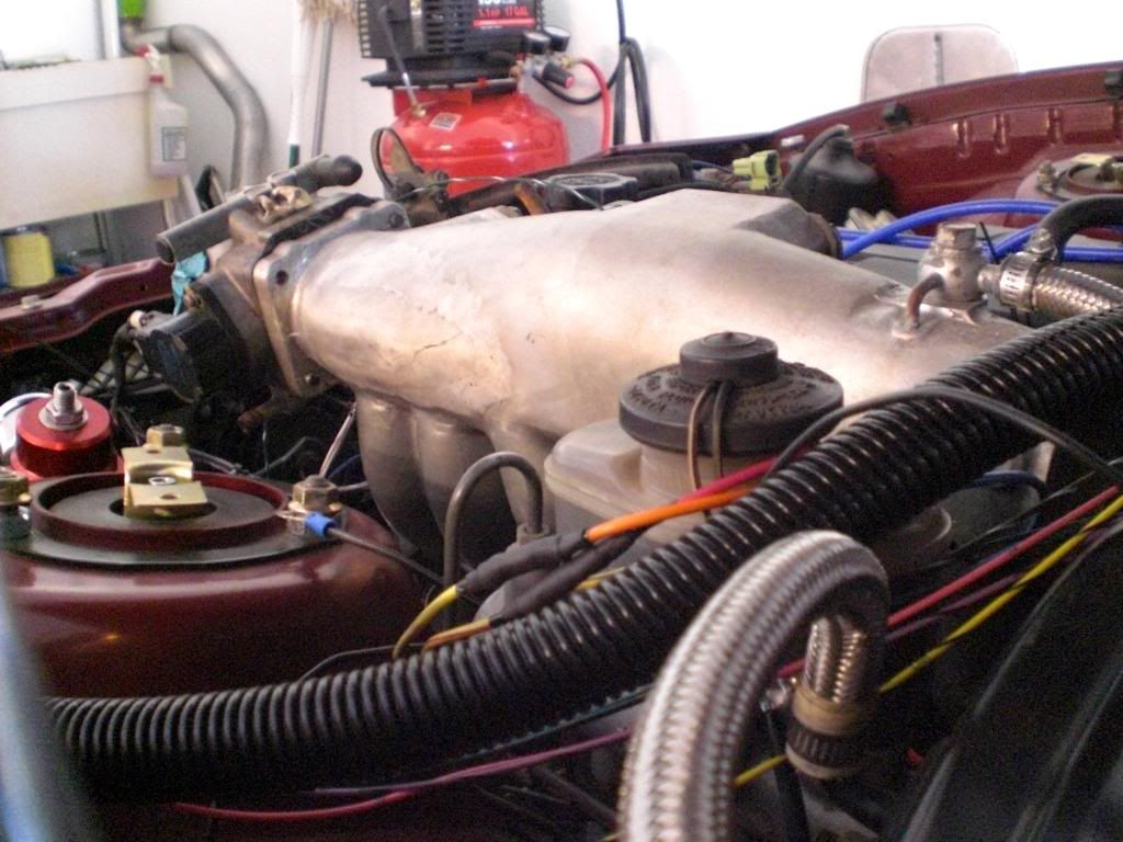

sethron71;1394198 said:
Did you forget about the hood? lol That will not clear the hood especially once you get an IC pipe out there, trust me I know from experience hence the coupler....
Seth
I had to cut a small section of the hood brace out but no big deal. The IC pipe fits fine tho. Ive got two more factory manifolds that Im thinkin bout cuttin up for different styles of FFIM. I wont have it that high again.
