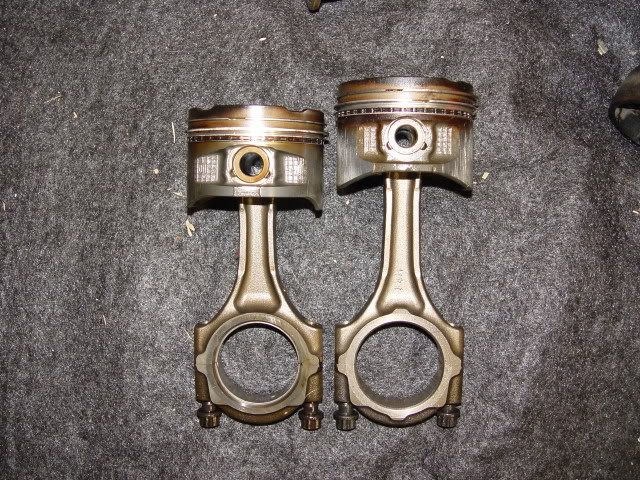

They are different. I looked into it a while back, I believe its something about skirt length.
Correct. By using an aftermarket piston, you can practically get any skirt length you want. Here's a comparison pic of a 1JZ (left) and 2JZ (right) piston/rod:
