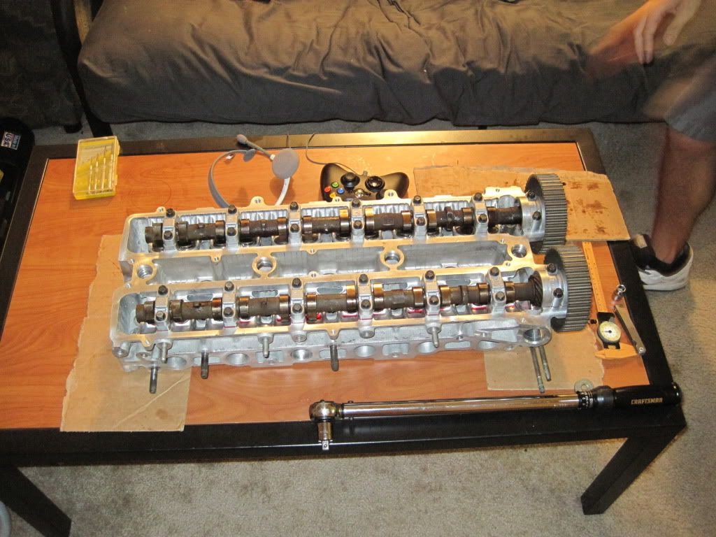

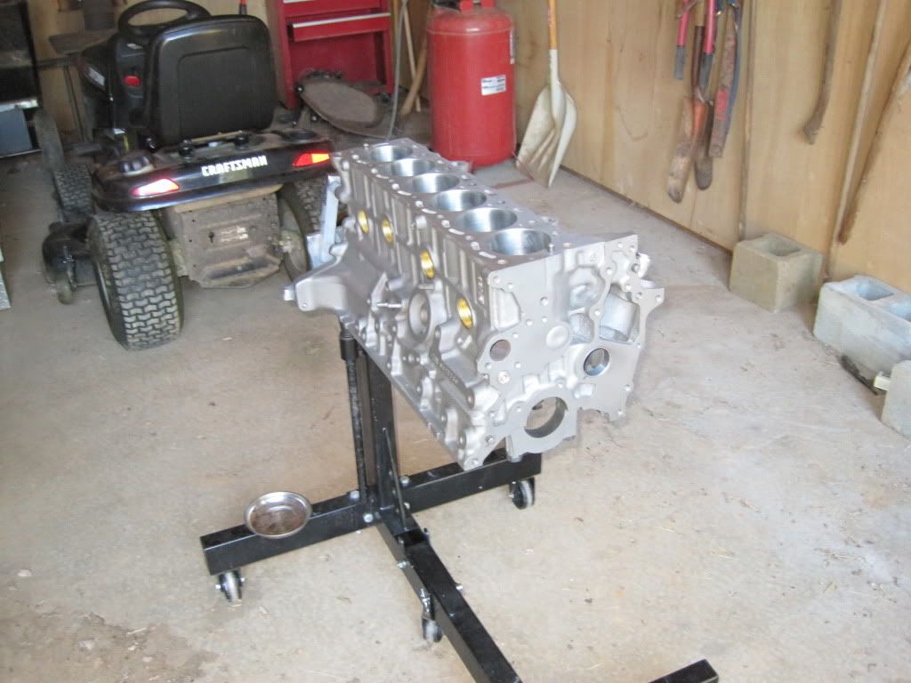

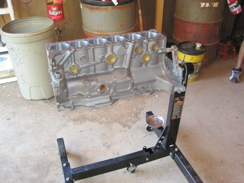

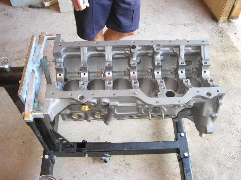

other than possibly getting new pistons I am just waiting on the MHG to come in and I should everything. Here are some random pics of the build.
