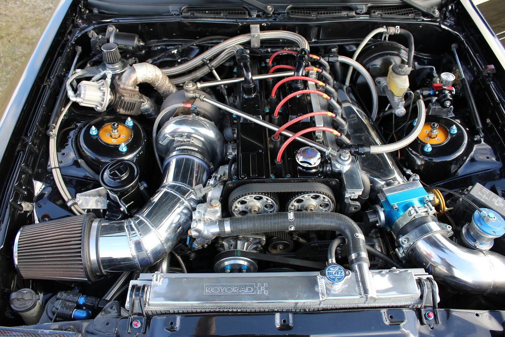

I put some info in the 1st vol.But heres abit more:
Fully rebuilt underneath with poly bushings allround,ST sway's bottom and Cusco's on top,XYZ 3 way coilovers,XYZ brakes 355/6 pot,330/4 pot,Alu fuelcell 10gal,Aeromotive Eliminator pump and filters,1000cc Injector Dynamics,AE regulator
Engine aslo fully rebuilt with ARP's allround,HKS stopper,Wiseco 060 over,Eagles,Clevites,rebuilt sump and oil system,BC 272 with spring/ret kit,Custom FFIM,Custom ex manifold,3,5" stainless homemade exhaust,GT45 china turbo (1 bar at 3800 rpm,2 bar at 4800),Vi-Pec standalone
Last dynapack: 578rwhp/650nm 6900rpm on 98 octan
Ive been running ethanol for 2 weeks now.No dynapack yet though
Gonna do another session in a few weeks

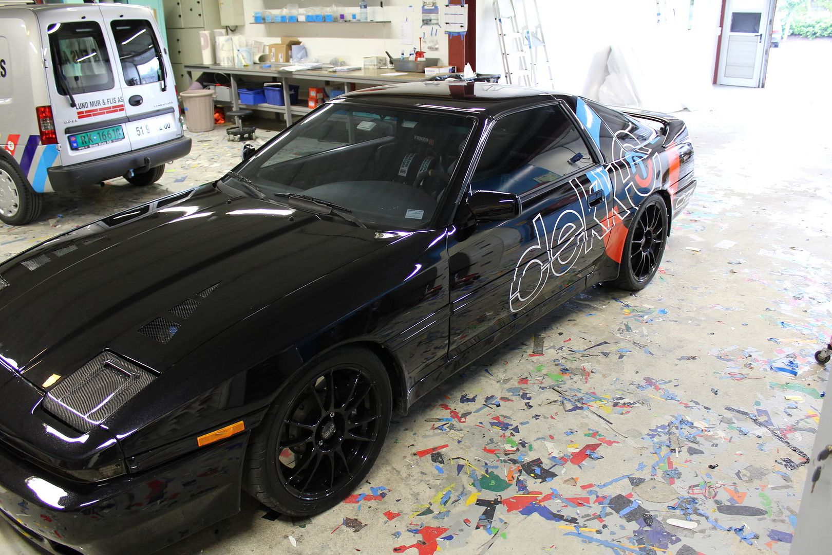

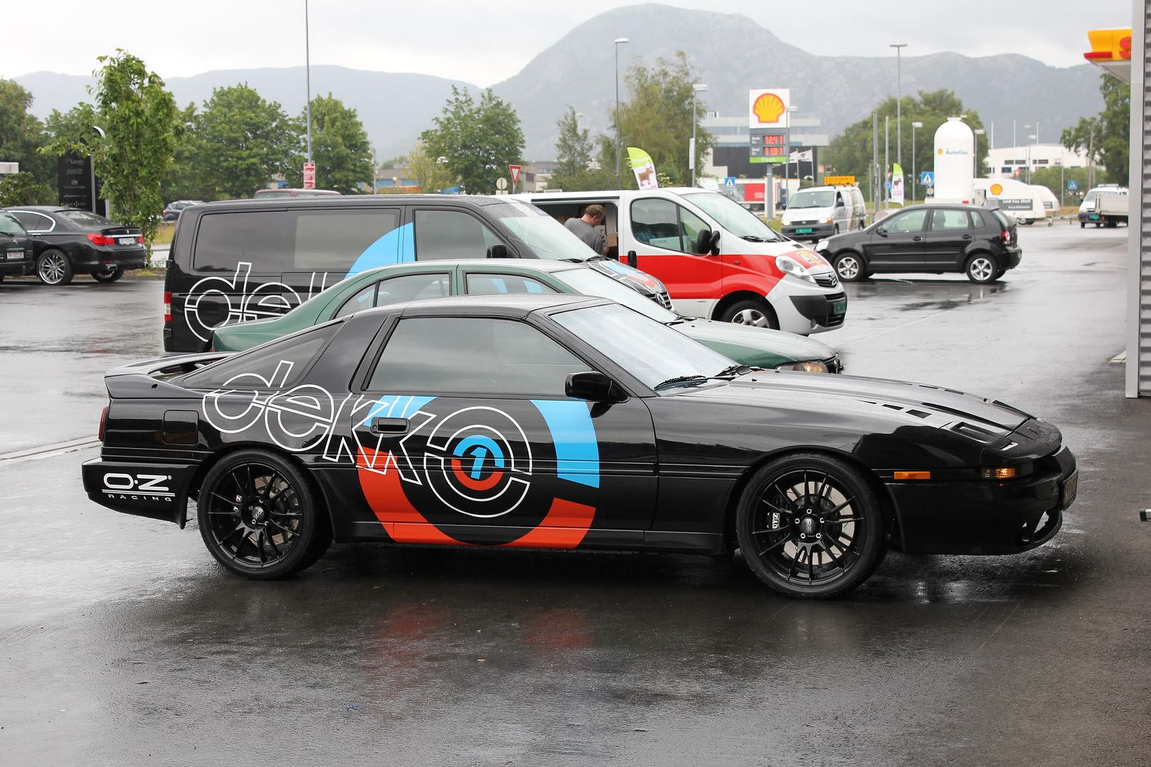

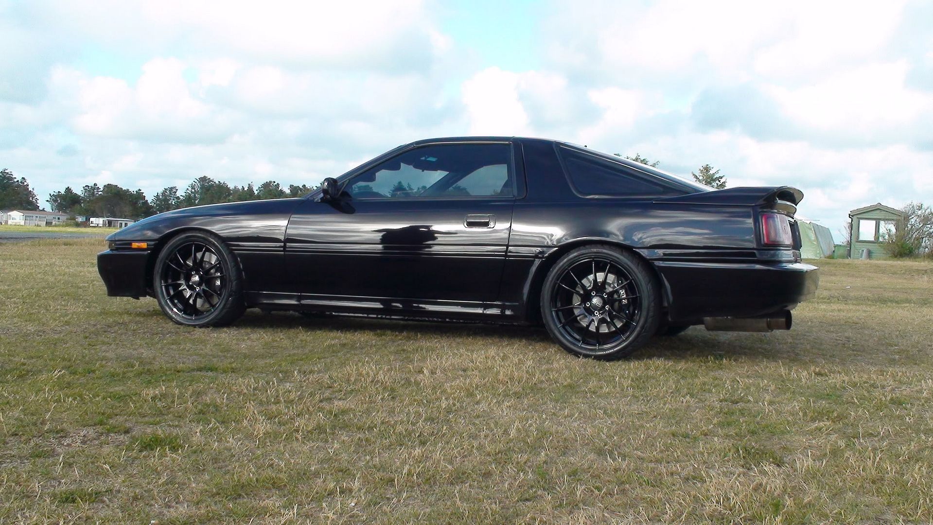

Heres a few pic's after paint.And a few after sponsor decals

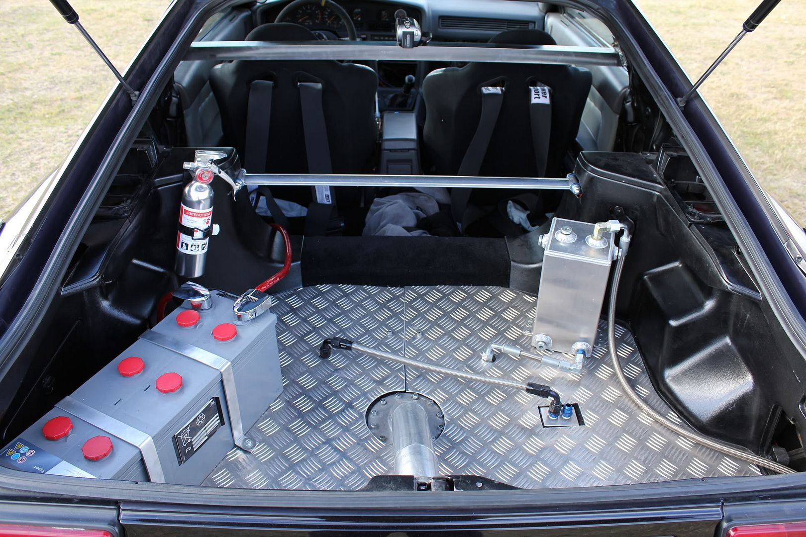

I know.The batteri is huge..Tired of running out of power,and i needed some weight on the left rear corner.Perfectly balaned now even tho its abit heavier

Yeah i havent touched the body except for widening the arches abit.Rebuilding bumpers,putting on side skirts and putting in a cage among other things this winter
