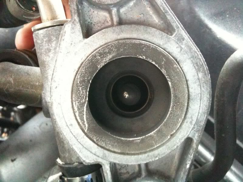

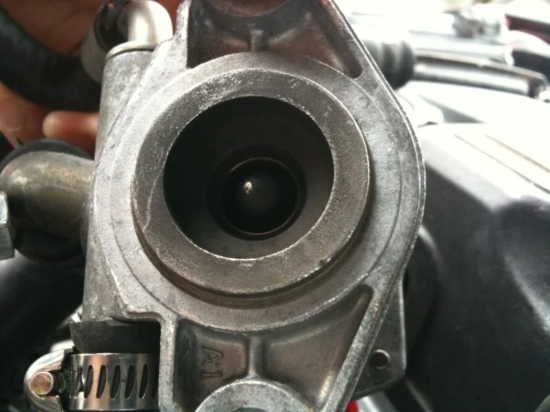

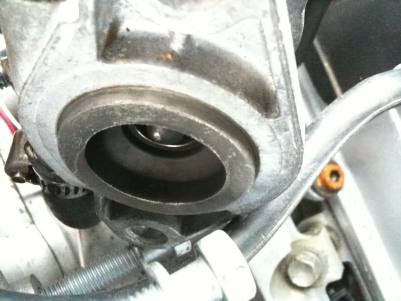

Am I missing something here on my ISCV?
on the EPC it shows some two parts that look removable, mine doesnt have anything of that sort. Not sure if different years have different set ups but what do you guys get out of this?
This is the Intake manifold side.
This is the ISCV itself.
89supra7mgte
Sep 20, 2009
797
colorado
yes you are missing the two pieces one is a check valve and the other is a rubber grommet. go to toyota dealership and tell them you need the iscv check valve and grommet should be cheap. best advice
will have vacuum and boost leak without
