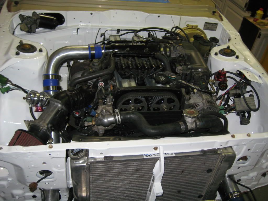

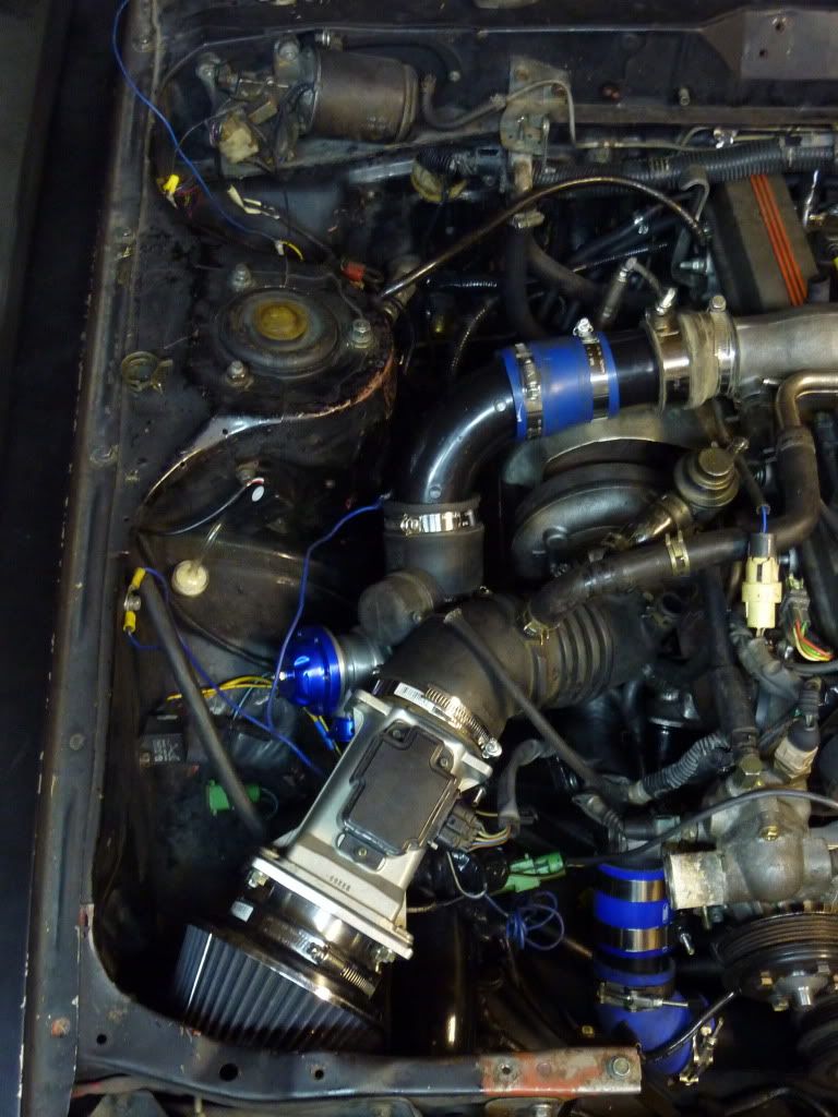

Hey this is speedfreak426 from the 1stgen Celica sites, I am sad to see that you are having all these issues trying to get this thing to fire up.
I don't know how current those pictures are that you posted, but I can see a few problems just by looking at those.
Get rid of the aftermarket BOV, it's going to only cause you issues, especially stalling. Just get a long bolt and lock it shut for now.
You have open holes inbetween the AFM and turbo, those could be causing several issues as well, but I assume you noticed and fixed that already.
I have some spare 7M electronics if you need other stuff to further diagnose the problem. Wish you lived closer so I could be a better help.
Here is how mine was set up a few years ago if that helps.
