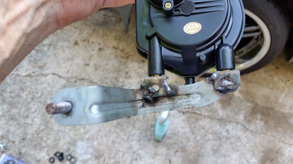

Done.
The only real problem I had, was that the supplied base retainer(against the inside of the quarter panel) was too large to use in the stock hole.
So I cut up the oem unit to use on the inside. I also reused the lower bracket, after welding in 90 degree tabs to fit the new antenna's mounting points.

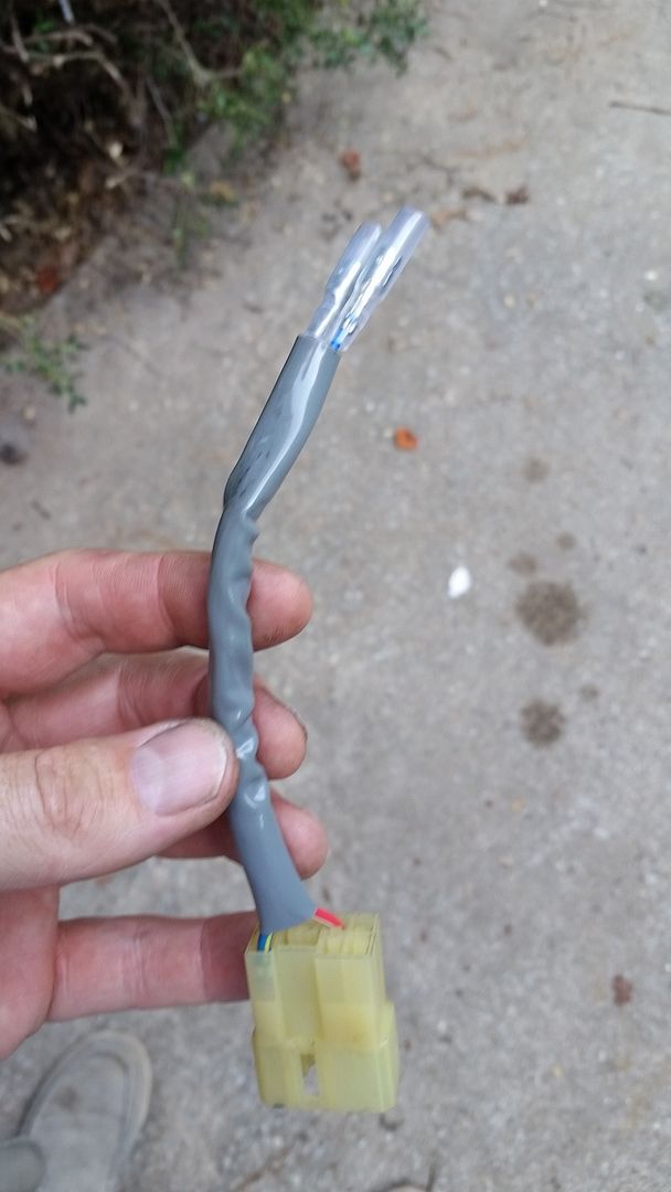

I also was able to cut off the plug from the old antenna, so that I could just plug the new antenna into it.
old vs. new:
Modified lower bracket and plug:
Mounted:
