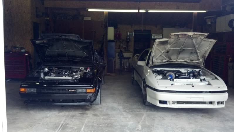

Mark (Mark1987supra) and I having a pow wow. Beautiful day in iowa can't wait to have the car running!

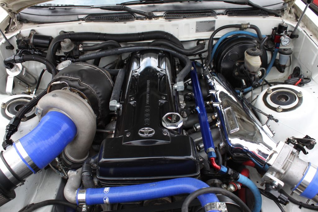

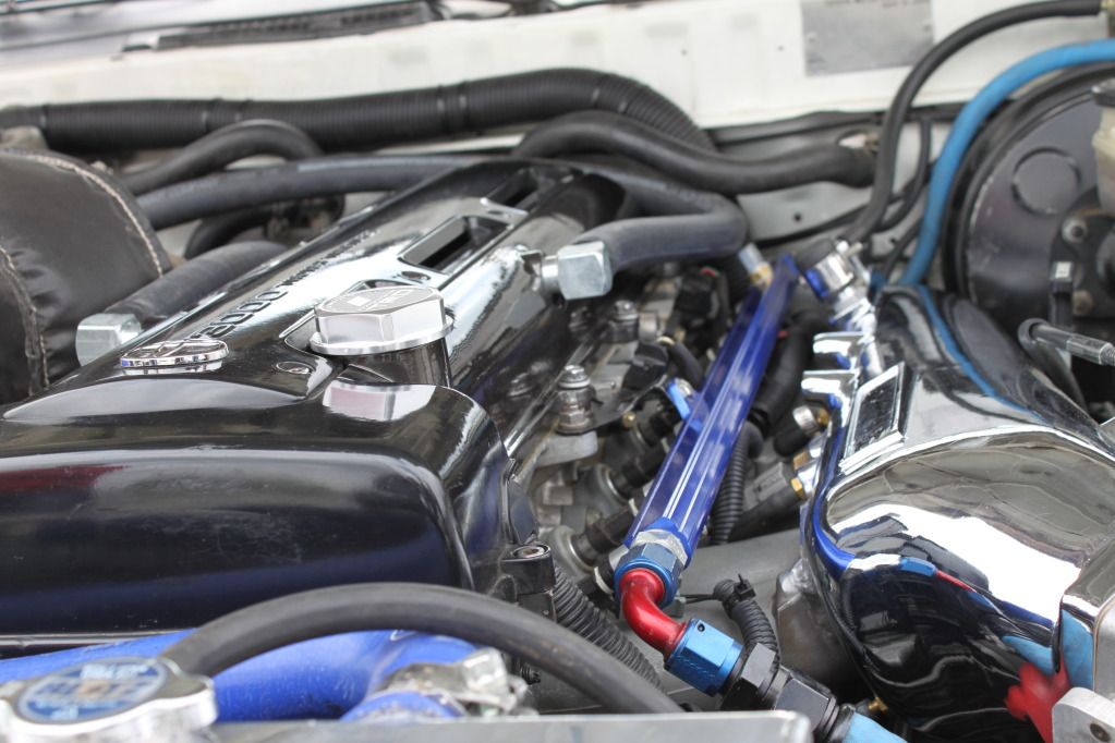

Some updated pics of the engine bay. Car is on the road and has a very conservative tune. Waiting for funds and time to have my tuner come down to actually tune the car.

Haha thanks andy! The part that bugs me is the heater hose pcv lines. Im still waiting on the braided stuff its taking way to long
