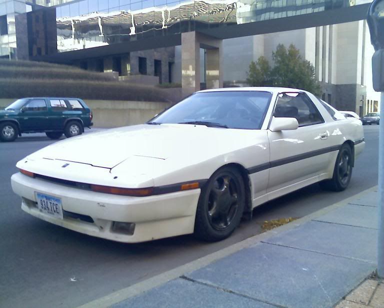

This a picture after the car got put back together.
I got the clutch broke in after that and slowly started turning the boost up. It was running right around 9 psi. Mods I added after that were Lexus afm, Apexi SAFC, Aeromotive Fuel Pressure Regulator.
I'm runnin right at 13 psi right now. I then went out and bought MK4 NA Wheels and threw on it. Heres a picture of that
Just put my turbo on a few days back its a vrp 57 trim from comp turbo.

BlindRonin said:
Yeah White 88's From arizona FTMFW!!!! Sweet car good luck with the build up
Mines actually pearl white. But pretty much the same thing. My cousin also has a 1988 7mge plain white with blue interior. He's still in the process of getting it to run.

Mine is Pearl as well but I am in need of a repaint. Are those Mk4's Bronzed, or black either way? I really like dark rims on White cars gunmetal Black Or bronze all loks really sweet

johnathan1 said:
Your supra looks good! Just pick it up off the ground, please! :D
Ya. I dont have adjustibles so I cant lift it off the ground. I need to do something with it in the future.
