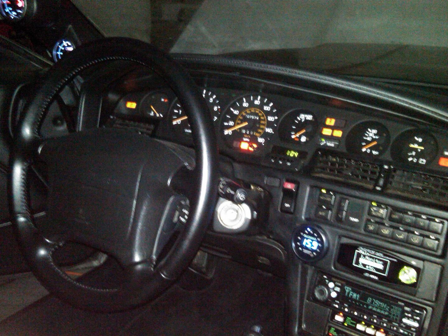

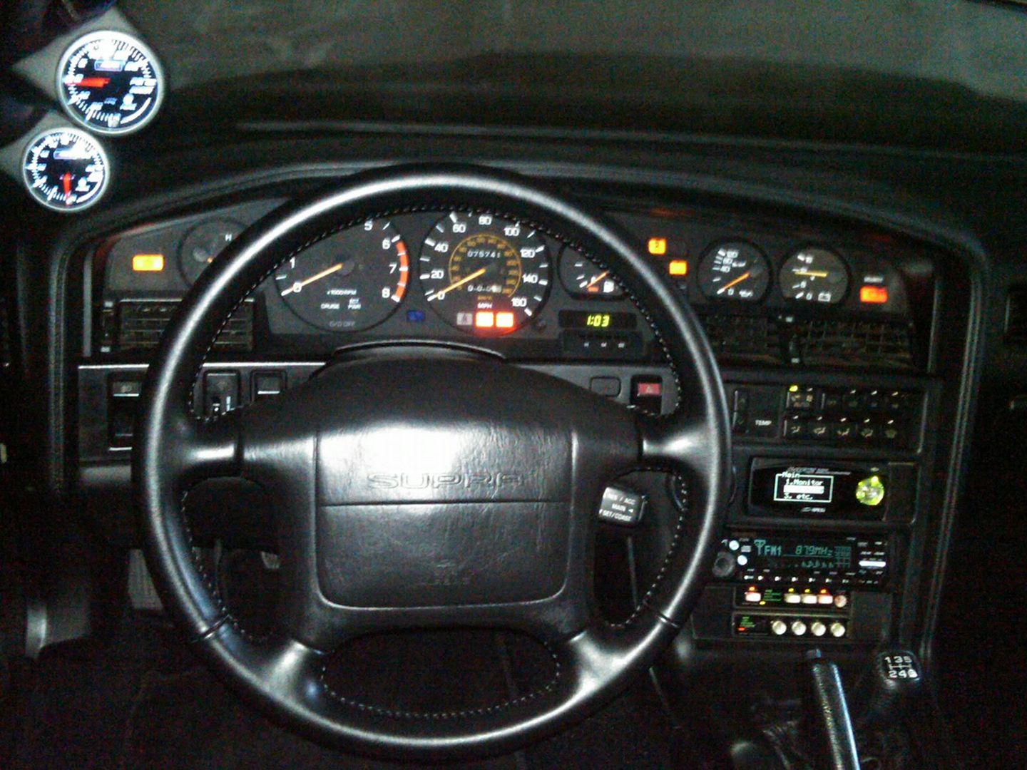

This is really driving me crazy. I turn the key and all that comes on are my guages, radio, lights and climate control. Nothing spliced into my ECU power is coming on. No WB, no EVC, VPC, TEMS controller nothing. When I tested the power going to the fuses in the engine bay, half of them don't have any juice going through. I figure I must be shorting out someone. I used to think this was due to not having most of my grounds connected. But now they all are.
