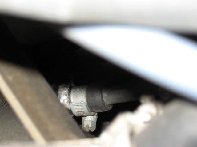

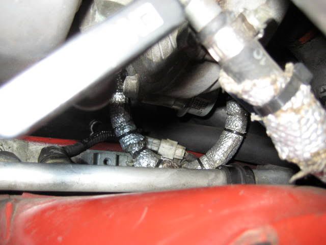

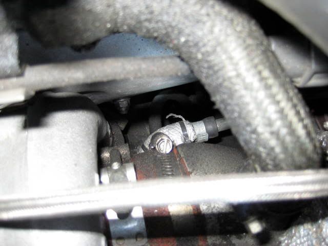

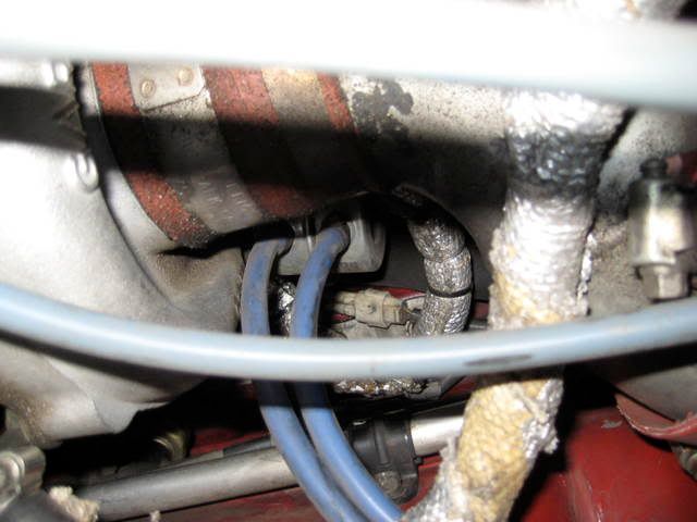

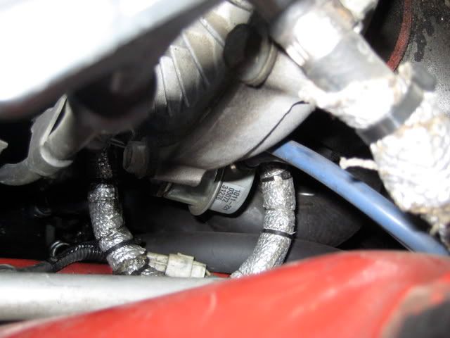

ive got some pics of a hose thats leaking coolant. i have no idea what it is but i want to get it replaced asap. all i know is that it is on the passenger side of the engine and i guess under the turbo. its a 91 if that matters. i cant see what it goes to or where it comes from. heres the pics, i hope someone can help.

GrimJack;1213667 said:
The only hose over there that carries coolant is to the turbo. And as that isn't a stock turbo, it's highly unlikely that it's a stock hose, either.
i see..... yea its not stock, i just know its the HKS sport turbo upgrade, which came with the car when i bought it. it comes from or goes to some little pipe, picture here
but of course i dont know what that is either.......

That is definitely the turbo coolant lines.
You'll need to visit your local auto parts place and buy a length of hi temp coolant hose in the correct diameter, then cut it to fit. VERY hi temp, too, those run right beside the exhaust manifold, and it gets DAMN hot there. Explains the heat tape stuff that's wrapped around the existing hose.

You might try your local hydraulic line repair shop. They'll have a much better grade of hose, and it will withstand much higher temps.
