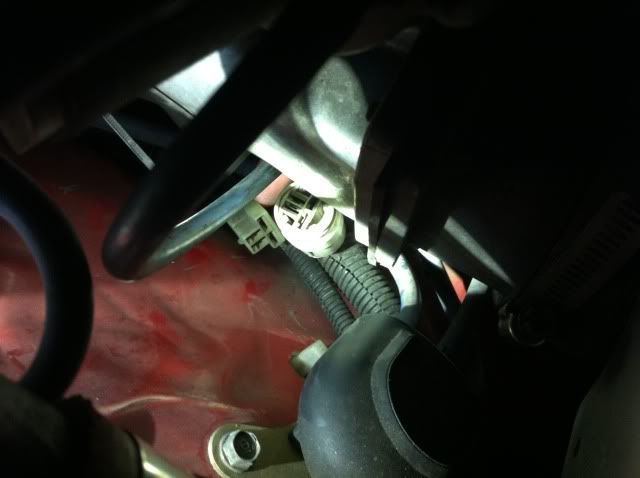

but also, i just noticed these 2 plugs under the AFM, can someone tell me what they're for or if they should be plugged somewhere?

Those have nothing to do with your code 31.
1 iirc is for a a/c temp switch on certain cars and idk what the other is for. Neither are used on most cars.
