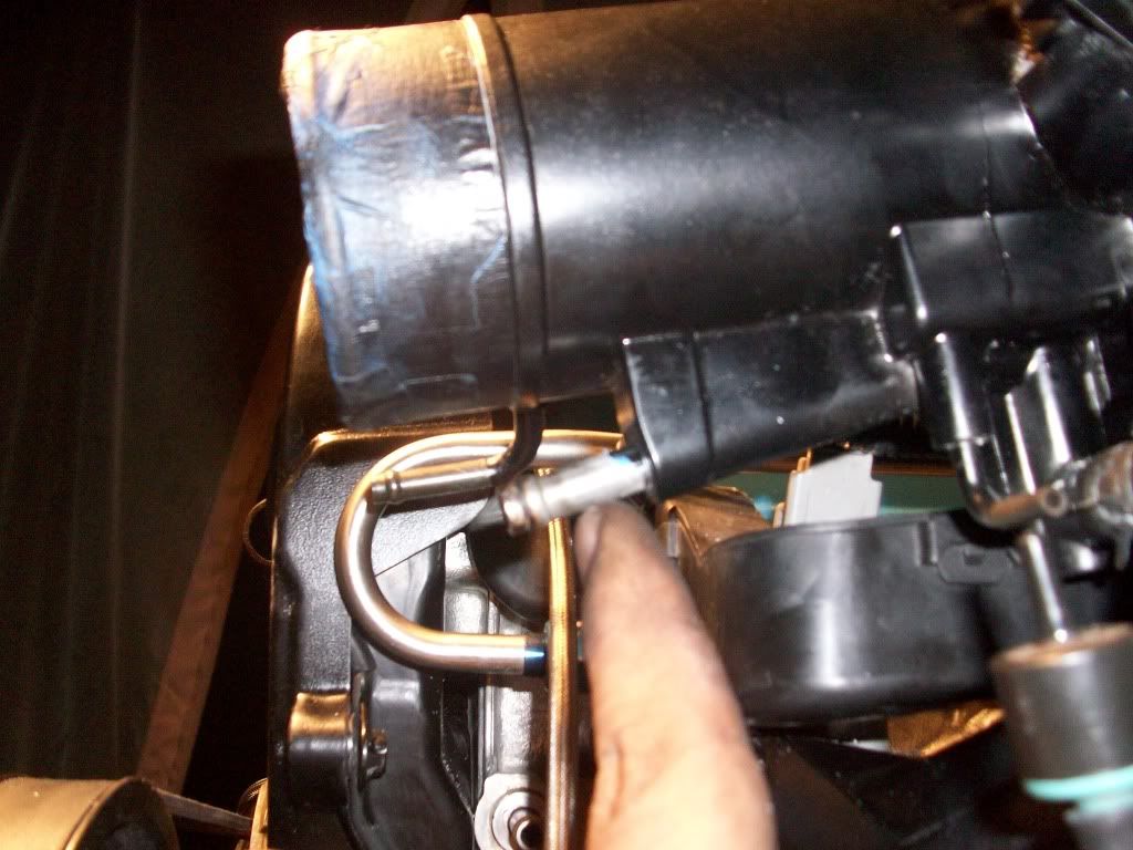

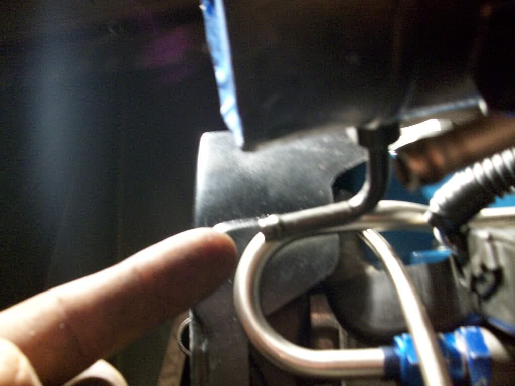

First pic, where does the nipple on the head go to? Where does the two nipples under the throttle body go to?

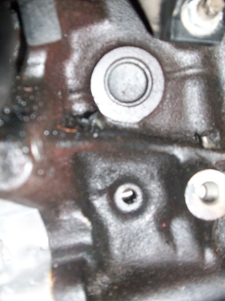

What is that hole under the freeze plug?

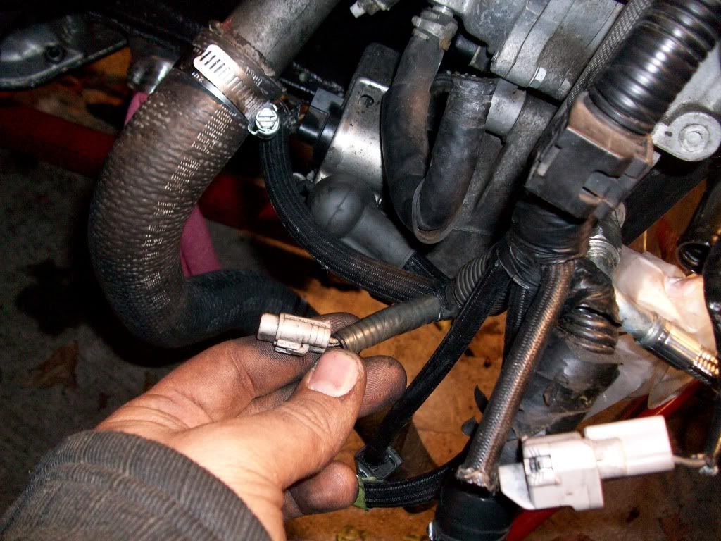

Where does this coolant line go to?

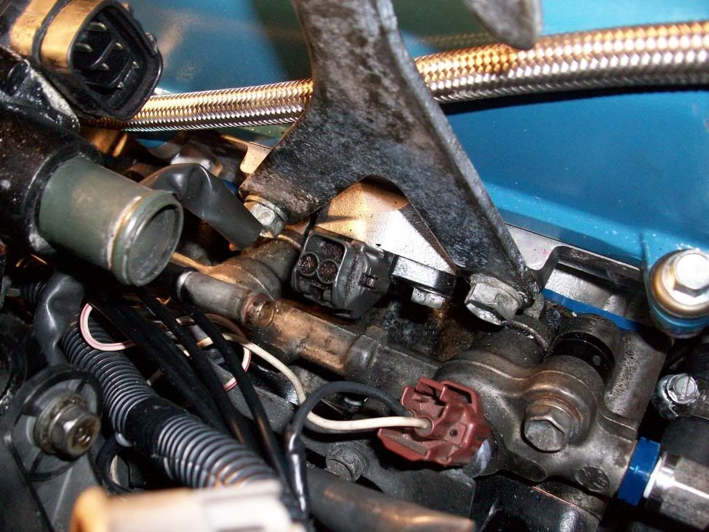

What is this plug for? (by the hydropump)

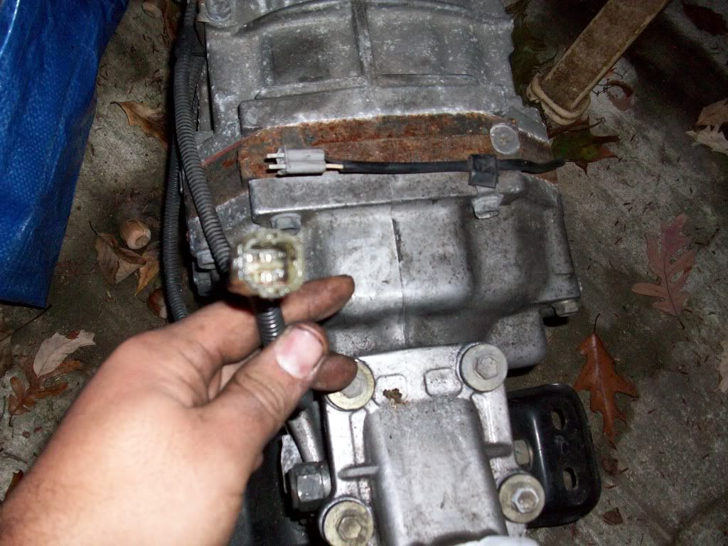

JDM Trans that came with my clip. Has ABS sensor w00t.
Also, does anyone have a spare plug for this sensor (cam) IIRC

nipple in first pic goes to the nipple in the second pic, for coolant flow goes back from the throttle to the ISCV down to the wraparound pipe
the third nipple is for the p/s idle up valve
thing under the freeze plug is for the oil pressure sensor
line on the water pump is for the stock twins, not needed unless u have a BB single turbo
plug in the picture is for some kind of stock exhaust temp sensor iirc
Thanks, i'm glad i saw that hole before i threw the motor in!. I guess i will use that for my feedline on my turbo.
Anyone happen to know the size?
