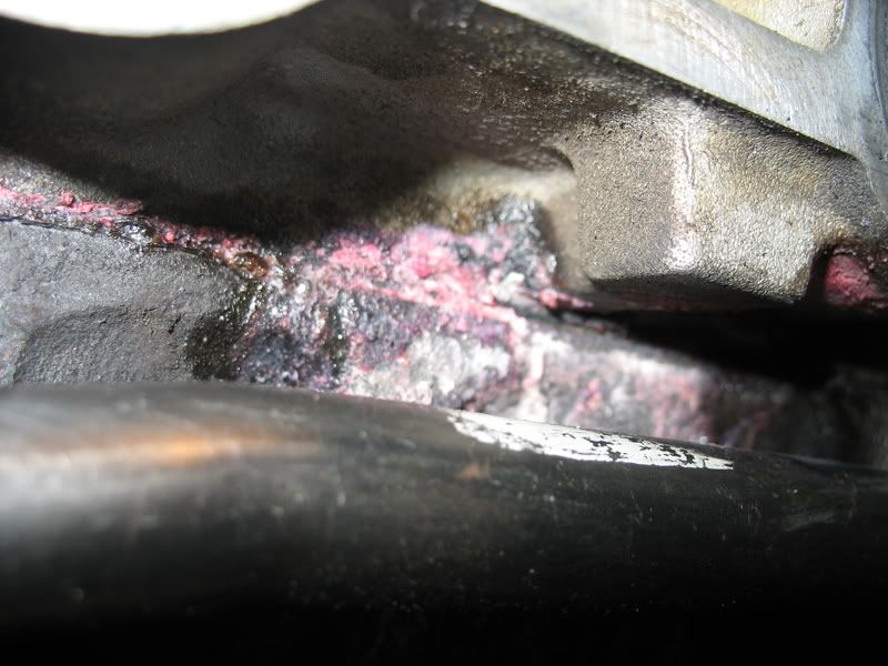

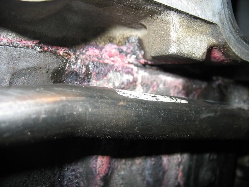

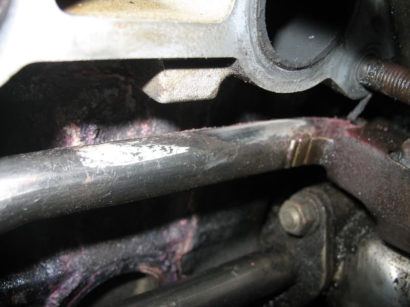

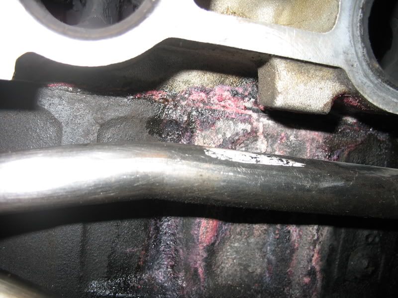

Pics after a half assed cleaning(wiping with shop towel):

if it were me and i was willing to further run with this problem, I would take a wire brush and clean all that crap off, maybe use some mild solvent/alcohol. Then I would take it for a spin and check for the leak to show it's face. then you don't have that crap everywhere and you'll know for sure. it migrated quite a bit from the leak, unless you leak spans a 4 inch distance. (no)
but that depends on what you find easier - hunting, or just fixing the headgasket anyway. it would tell you if its the gasket though, maybe. right now it's a mess everywhere so...who knows. sounds more like the gasket than a hole in the head though. used a mirror to check up underneath the #1 exaust port is yet? a mirror is your friend when looking for leaks.

maybe just scraping off the residue on the surface - chances are (in my mind, i'm guessin' here) that the leak is in one spot, a small spot, given it only leaks under severe loads. Soo if you scrape rather evenly everywhere along the block/head seal and look for the spot where it goes deeper than just residue on the surface you've found you leak.
Like i said though i'm just guessing and when you scrape it off, you might get rid of all the residue and not leave any spots behind that could be suspect leaks...
that hard line is a coolant hose though, yes? just to save yourself an assload of trouble before you go further - get a small mirror and a flashlight and look at the hard line from the backside, maybe brush it with steel wool to make it clean - as long as that's advisable and won't cause corrosion. i don't think it will. look for that pinhole discussed earlier.
Uhh, did you say this was a metal headgasket? I forgot. it's a far cry but i've read about some people not removing some sort of funny rivet thing and causing....er...preventing a seal by holding a corner of the head up.
Anyway, on a different note - you checked your oil for coolant right? If you haven't you should. I wouldn't run the engine if it had signs of water in the OIL (fuck). hopefully its just isolated to the outside of the block if it is a BHG.

I amy have missed it, but have you checked the gasket where the water neck attaches to the block and the small rubber coolant hose from that hard line to the fitting on the water neck? Looks like there's more deposits in that area.
Yes I did, they seem to be ok. Were you looking at the cleaned up pics? The earlier ones show heavy deposits on the block and the hardline a few inches away from either of those fittings. After I wiped off the heavy deposits, the debris was concentrated forward of the original areas.

Yes I did...that's why I asked. I was thinking the coolant may have migrated aft of the leak to the block/hardline.

I see your point, but I have now looked at it for nearly 15 minutes with a handy mirror and can confidently say it's the head gasket. I'm nearly positive the water jackets between 1 & 2 have lost their seal and are letting coolant seep to the edge of the block, and apparently at times they squirt fluid through pinhole leaks.
-I cannot find any other likely source. The gasket line for the hardline fitting nearby is covered in oil and dirt with zero signs of any coolant seepage.
-The fitting holding the rubber hose onto the hardline shows similar characteristics with no coolant seepage.
I'm 95+% positive its the head gasket and this is where the leak is originating:
