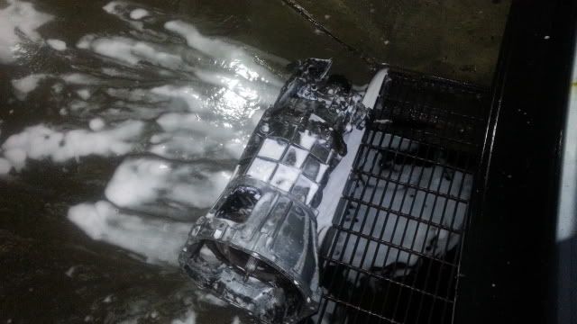

r154 sitting
cleaned the r154 up a bit. It was used from some craigslist add. Thats all I know about it.

r154 sitting
